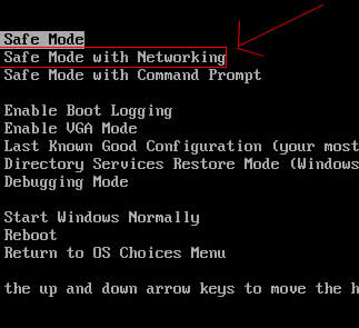

Have you tried running windows in safe mode with networking?
Running windows in safe mode
Power on the pc, press and hold "F8" until you get the option to select to run your pc in "safe mode w/ networking". Should get a screen similar to the image. If your nic isn’t already enabled try enabling it and what are the results?
If it works in safe mode with no problems try going back to a regular windows boot and see if you still have problems, theres a possibility that IRQ's are conflicting with one another.
