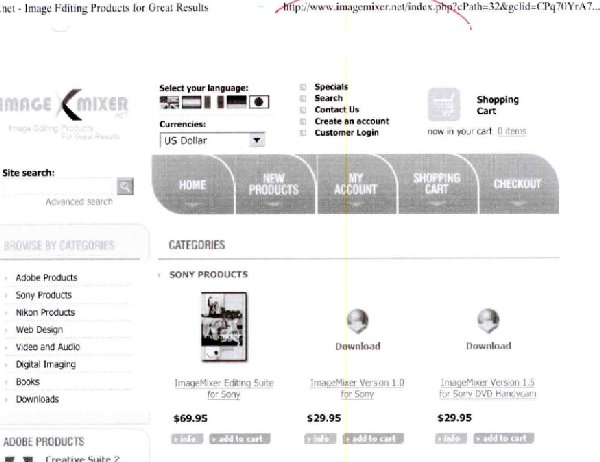

Username: Kannonji
Post Number: 8
>>Chris,
I uploaded the evidence that Mr. Yates was selling Imagemixer software before.. sorry, this is black and white 'cause I was asked to send it to Pixela Japan by pdf.. I need to find better-looking one, but this must be enough to show Mr. Yates was selling Pixela Imagemixer!Upload
