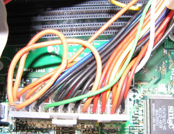

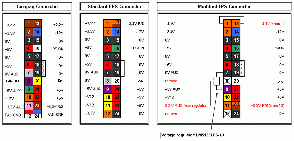

Username: Johny_b
I have succesfully started a P4-based Compaq Presario 5330US (with a 24 Pin original PSU 255712-002 or HP-U250XC3) using a 20+4 ATX PSU, by rearranging the wires.
The system works ok, stable for almost a month now, and the only downside is that I haven't figured out how to start the ATX source using the compaq power buton.I just start the computer using my surge protector switch.
I did't cut any wires from the ATX source (in case I want to return it;), I just removed the pins from the connector and rearranged them.While you normally need a tool for this (ATX Molex Female Pin remover), I used some bent pairs of common staples (see picture).
I did remove two orange wires (pins with 3 inches of wire) from the from the old (non working) PSU - I refer to them as "old wire"
The first 20 pins almost remain the same , with some changes:
- remove pin 13 (orange, brown), and put an old wire pin in its place that you connect to pin 1.
- remove pin 8 (gray wire) and seal it with duck tape, remove the white wire next to it (pin 20) and move it into pin 8 position.
- Use an old wire to connect the (now empty) pin 20 to pin 13 (orange).
The last 4 pins change a bit
- remove pin 11 (yellow) and seal it with duct tape
- remove pin 12 (orange) and move it into pin 11 position.
- remove pin 23 (red) and move into pin 12 position.
- in the now-empty pin 23 comes the orange-brown wire removed at step 1.
All the other wires remain the same.
Good luck

It seems to me that Pin 12 is an outgoing connection from the motherboard to the power supply with a variable voltage to control the speed of the fan. Why do you connect these pins?
Also I don't understand why you exchange pin 13 for pin 1. They are both 3.3V.
By the way i used a voltage regulator (LMS1587CS-3.3) to make an extra 3.3V AUX line from the 5V AUX line that comes from the power supply to Pin 11 at the motherboard. Now some LED's at the motherboard and networkconnector light up when the PC is off. Just as it should be. This way I think the Power Button should work again.
At the moment I still have the problem that the PC doesn't want to start and the Power LED flashes red. Like something is using to much current.
Username: Johny_b
Henry,
1.I changed pin 13 for pin 1 because pin 1 is a different +3.3V, it has "remote sensing", a feature allowing the PS to compensate for voltage drops across long connector cables.
That's what R/S stands for in the Compaq pinout of pin 13.
2.As for pin 12, I just put it there because it has the same color as the +5V lines, so it should be the same."Fan Sink" is more problematic, I just left the com line and it does the job, but I suspect it could be more than that.
3.Converting the 5V Aux to 3.3 is a good idea, even though it might create uncertainty of its own ("does it work properly under load?").
Google says that AUX denotes a separate line used by the Wake-On-LAN feature of the NIC, so the network leds should light up.And it could also be related to our Power button :-)
Try doing point 1. and 2. and see what you get.

I finaly found a method to safely remove pins from the power connector. Now I have modified the standard power supply like in the drawing below.
modified power supply
The regular PS didn't have a white wire on pin 20 and the Compaq PS didn't have anything on pin 8.
When I connect the modified PS to the mainboard and the harddisk of my PC and plug in the powercable, all the LED's on the mainboard light up like they should do but the powerlight flashes red.
According to the Compaq Service Reference Guide this indicates that the power supply cannot deliver enough current.
When I push the on/off-button of the PC it tries to start up but after a second or two it switches off again. Without the extra 3.3V AUX-line the on/off-button didn't work.
I still have to check the current for both the AUX-lines when the PC is in standby and when it is running. However I can't imagine why the PC uses up so much current in standby mode that makes the powerlight flash.

My respects to Henry for the detailed diagram posted above, I'm sure others will find it as usefull as I did.
As my 5330 Compaq (with a similar P4 mainboard) runs stable on a similarly modified ATX PS, except for pin 12 and 11, I can only assume there's a problem with your pin 12 or 11, or the mainboard/power supply are defective.
It could be that two separate AUX lines from a single one result in insufficient amperage on either one, so the mainboard regulators refuse to start.Not knowing how your regulator performs and interfere at startup is another issue.
I suggest you change pin 11 as I did (directly from a 3.3 line), to check that the mainboard isn't dead to begin with, and worry later about the power button.The leds lighting up on the mainboard don't mean much, I think a network PCI card would do the same if you apply proper current to it.
If there's still no response, consider changing pin 12 as well, although I cannot give you better reason except that it works for me.
The power button works for me only in the sense that it can place/wake the system to/from standby, but it cannot start/stop the PS.

@Henry - your problem is most likely pin 20.
According to a PDF I found from COMPAQ itself, pin 20 sould be -5V.
I adjusted your diagram to reflect this (I also changed the orientation of the diagram - it is now viewed from the PIN SIDE of the PSU plug).
(Photobucket link incase the attachment doesn't work...)
http://i155.photobucket.com/albums/s318/paulpsomiadis/ATX_24_to_COMPAQ_rewire.gif
Give it a go...

Since someone contacted me about this, here's an update with some things fixed and others added - including the custom 'secondary' connector...
http://i155.photobucket.com/albums/s318/paulpsomiadis/compaq_psu_atx_mod_no2_imp roved.jpg
[IMG]http://i155.photobucket.com/albums/s318/paulpsomiadis/compaq_psu_atx_mod_no2_imp roved.jpg[/IMG]
I don't know if the secondary connector is necessary to power-up the mainboard, but I had it plugged in when using the original COMPAQ PSU.
Also, although the voltage regulator circuit seems to have two separate GND wires, they can both be connected to the same 0V GND line.
