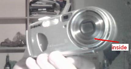

I found that the real reason of the failure to move as it should of the lens is also mechanical: it involves the wrong positioning of a black rubber o-ring located between the inner and the outer moving sections of the lens.
Why the rubber goes away from the correct position can be related to sand and dirt but more probable to the presence of humidity. Once the rubber is misplaced it generates the error because it avoids the smooth movement of the lens.

In my case the o-ring was so badly misplaced that at some point I was able to see it appear at the boundary of the 2 moving pieces...

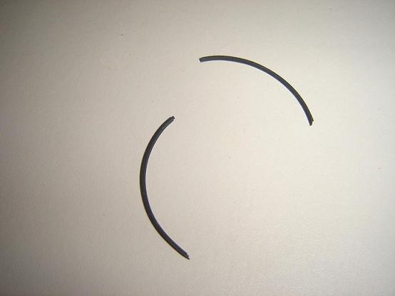

I pull it out, I broke it and I extracted one part ... then the camera worked fine for a few minutes...started to fail again (because I had extracted only a portion of the o-ring) and after moving with my hand helping the mechanism many times the other extreme of the rubber appeared...I was able to extract the remaining and now everything works perfectly well....
This explains also why some people have manage to fix the problem (usually they imagine they fixed the positions of the gears) just by helping the mechanism to open and close the lens many many times for a few minutes.... The truth is that at some point the rubber goes to the correct position and the problem is solved.... I think now that this approach may be the best because it works for the real problem.
