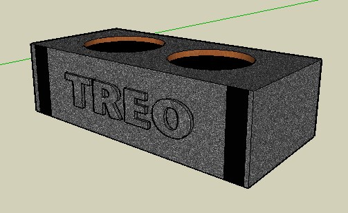

Box for my neighbor... 2 Treo SSi 15s in the back of a Jeep GC.
Username: Jakeyplaysbass
St. Louis, MO / ASU
Post Number: 2850
3.25cuft on each side tuned to 33hz.

guys these boxes are all looking great. chad time for 2 revo's i guess man lol.
Username: Insearchofbass
Post Number: 9569
looks good Jake....should work well for the jeep

Jake - that looks really nice
box a bit undersized but those treos hit really hard & sweet

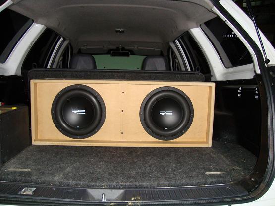

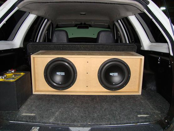

well guys this evening i made that sealed box for my 2 10s RE SE
SUCCESS !
yes its slightly less loud but now ur getting like every single bass note ineach song - sounding sorta like surround sound bass ...super deep too
each of my ported temp boxes was 1.7 tuned to 32hz now each sub is in its own 0.8cuft sealed chamber & d box looks so small & weak as if it wont do a damn thing but man its sick ! - cant sit in d back seat of wagon because ur feeling as if something is crawling in ur hair - cabin gain FTW !
...wish i had some 1" to build it though since it would be even more rigid & output even more ... }

Post Number: 13919
has a 2' lip on front which i might trim off a lil bit - that is if i choose to run some bars like a grill in front it or not
separated chambers ...0.8 cuft
36 x 13 tall x 12" deep

Now that's a solid looking box.
Username: Nyyfan13
15 Mag
Post Number: 9879
Nice box Rovin. Looks great man.

well Chad if a slot port is louder than two four inch aero ports I dont think it will be by much with 1200 watts
Diamond Member
Post Number: 21453
well its just i don't know what to do about the risers. to get 4 inch clearance i need at least 2 inch risers. i don't know what i would do.
he did say aeroport might sound better. also i asked him if i do 2 aeroports, do i put both ports on one side and sub on the other or sub in the middle and port on each side. he went with sub in the middle.
most likely ima go with the aeros since i bought them. but give me some ideas on risers.
Post Number: 9648
this would be a bit of a pain but you could design the box for both port styles and see what each one sounds like

i was thinking port to the side but scott said don't do it so that idea is out the door. i got several days to think about it so its no hurry.
Post Number: 9649
well with sub in the middle with the ports on each side you couldnt do a swappable aero port and slot port box

Chad yeah think it over but im not so sure it will make much difference if you put the port to the side
