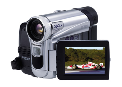

Hi guys,
the issue is that I don't have a firewire cable and I need to transfer the video now!
I borrowed the camera and the lender can't find the cable.
Am I right to say that with no exceptions a USB connection won't transfer video to a laptop?
Also, does this camcorder require any drivers/software to transfer the video from the MiniDV?
Thank you so much.

USB doesn't work on mine, u can only extract photos out.
Username: Ieee488
Post Number: 85
Firewire. Period.
If you had bothered downloading and reading the owner's manual, you'd known that.

It connects via USB for getting still images ie photos that you saved to the miniDV tape and for allowing you to view the video on your computer. My Panasonic PV GS15 is the same way.
BUT to do what you want to do - transfer video to your PC, you must use the iLink aka IEEE1394 aka Firewire 400. If you don't want to use Firewire, you can use the audio/video cable item#5 on page 3 of the manual and a video capture card installed on your PC.
