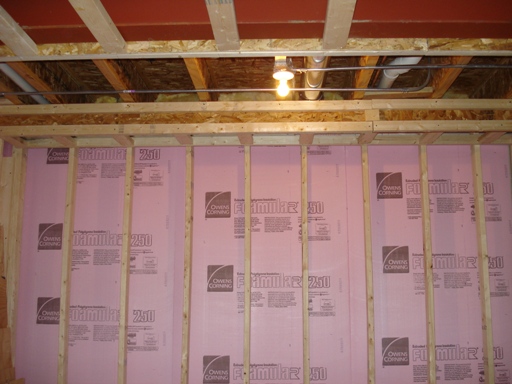

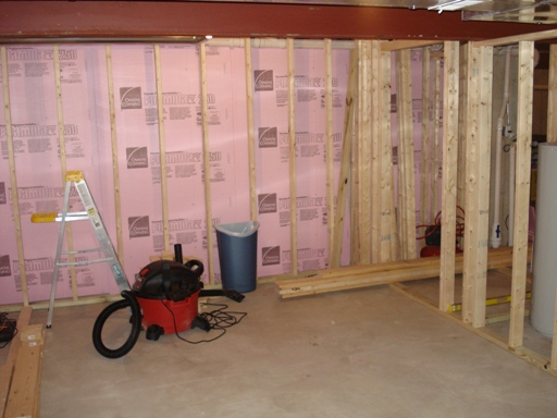

We moved into our new house a couple months ago. I started building a home theater room in the basement two weeks ago. I'm hoping to begin electrical work by the end of the month, and I will post more pictures as the room progresses. Here are some pictures:

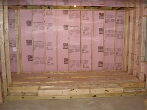

View from the front of the room, looking at the riser. I still need to screw plywood onto the top of the riser.
View of the entrance into the home theater.
View of the front of the room from the riser. The doorway to the right leads to the equipment/media closet.

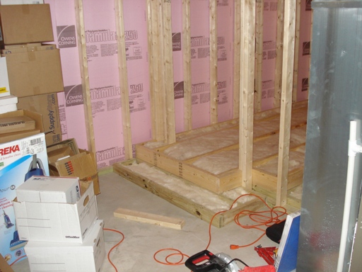

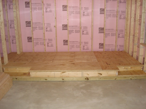

The entrance is in the back, where the riser is. Given the position of my furnace and water heater, the entrance had to go on that side of the room. The riser allows the back row of seating to see the screen.
The optimal location of the riser was at the side of the room where the doorway is because the HVAC trunks and a steel I-beam hang down from the ceiling too close to the front of the room. You can see the red I-beam in the last picture above.
So, as you can see in the picture, there are two steps outside the entrance, so when you walk in, you are already standing on the riser.
I did lots of research and planning before starting this project, including line-of-sight calculations for all the seating positions, head room measurements, etc. What specific mistake is it that you think I've made?

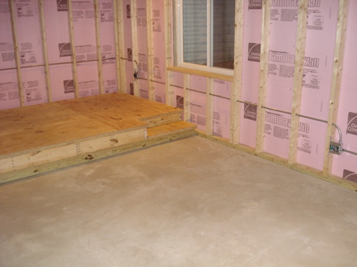

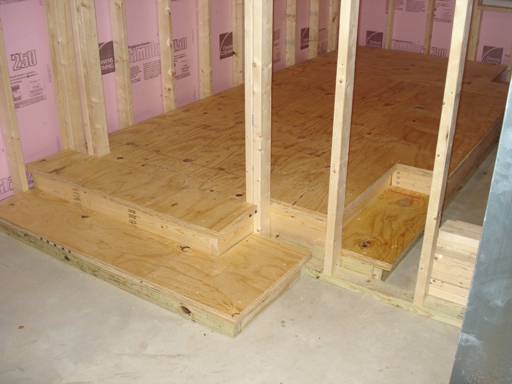

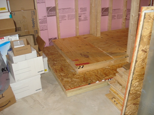

Here are a couple pictures of the completed riser. Soffits and electrical work next.

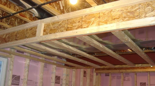

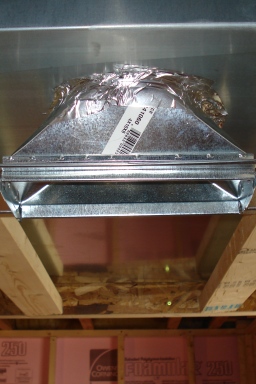

Here's the main soffit that covers the HVAC supply/return trunks and an I-beam.
Here's a small soffit at the front of the room that covers a small heating duct.
This is where I added a supply duct for the room.

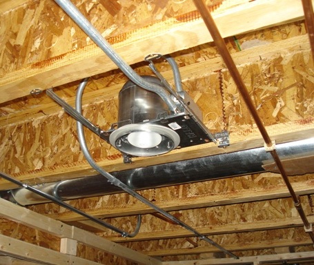

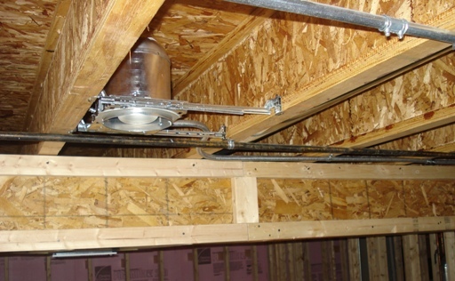

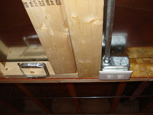

I've completed the electrical work. Here are some pictures of a couple of the recessed fixtures.

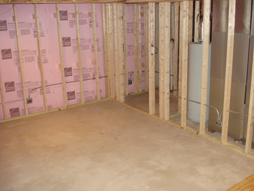

Here are a couple of pictures of the room as it is now. You can see the conduit runs for the receptacles. I think I'm ready for my pre-drywall inspection.

Looks great!!! Is conduit code where you are or just what you wanted to do? Inspectors here in Michigan would be thinking you were hiding something if work was done this well!!!
Username: Floyd_1977
Montgomery, IL
Post Number: 113
Thanks, Jim.
I live in Montgomery, IL, and I know conduit is required here. I think it might even be part of the state-wide electrical code for new construction, but I'm not sure of that.
I think there are good reasons for using conduit, but I found it pretty challenging making all those bends and fitting everything together. It's nice to have that part done. Hopefully the inspection goes well.

I hate to do this and I am no master electrician (I am an engineer however) but I am in the business of knowing this stuff and a constant learning curve is expected. I therefore did some checking and your village does not appear to have any code deviations from national standards. From their website:
* Building Codes used in Montgomery –
International Property Maintenance Code, 2006 Edition
International Residential Code, 2006 Edition
International Building Code, 2006 Edition
International Mechanical Code, 2006 Edition
National Electrical Code, 2005 Edition
State Plumbing Code
If this is true then the national standard does not require conduit (in a covered location such as a stud wall) and I would really appreciate you asking your inspector if you were correct in your assumption that conduit was required. If you are correct then that means that I REALLY need to call each building department of every city I work in. If I am correct, you still have done an extremely good job and the potential for you to fly through your inspection is very high!!

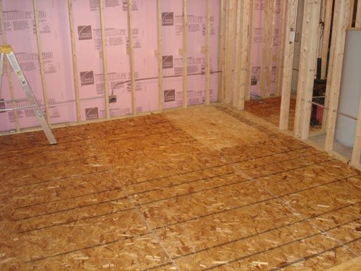

Rough inspection complete. Woohoo!
I extended the steps outside the door since the door will swing outward, and I don't want the door to swing out over the steps.
I realized that placing the projector on a shelf at the back of the room would not give much headroom. I don't want people to have to worry about blocking the projector when they move around, so I ran some more conduit and installed another receptacle underneath the soffit in the middle of the room. On the left is a mud ring where I will attach a recessed low voltage wall plate to feed the video cables through. I also put in some blocking, so I can mount the projector in the center of the room.
I put down some 3/4" OSB for a subfloor.
