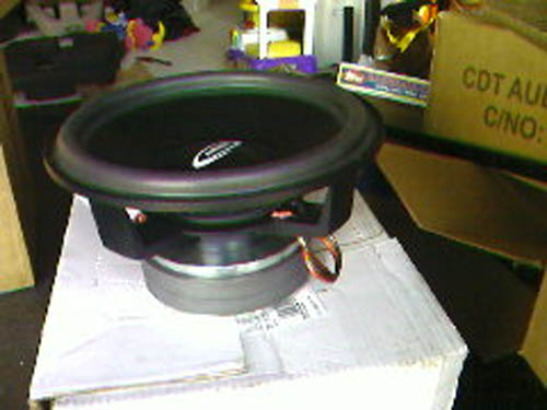

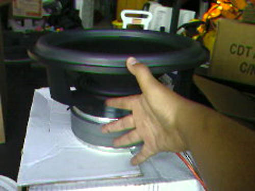

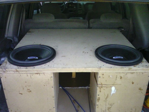

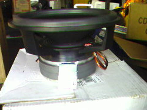

More pictures of the sub's when I got them. Beginning of October.

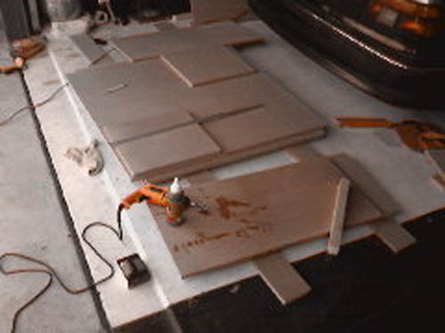

Went and got the wood the next day to begin on the box.

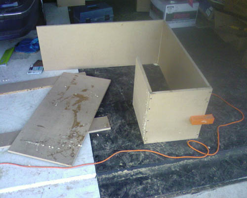

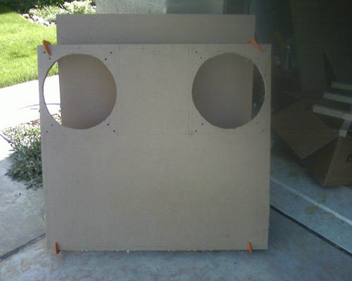

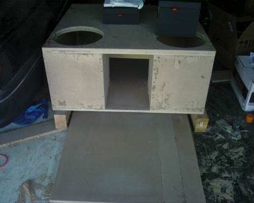

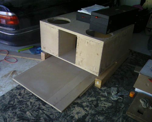

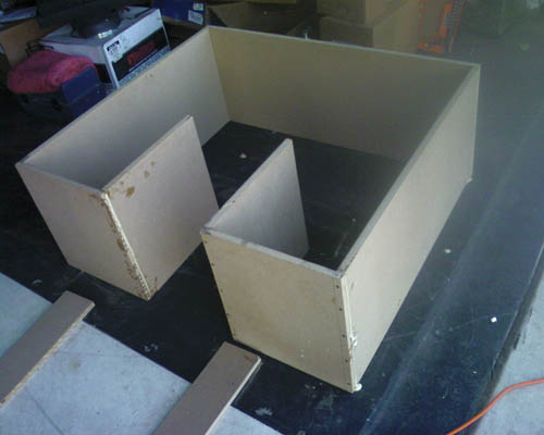

Putting the box together and cutting out the hole for the subwoofer.
Test fit.
Double Baffle glued and complete.

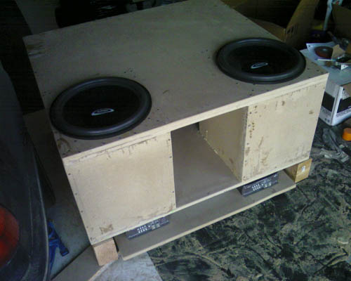

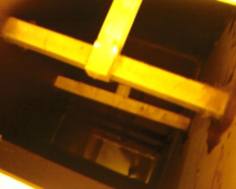

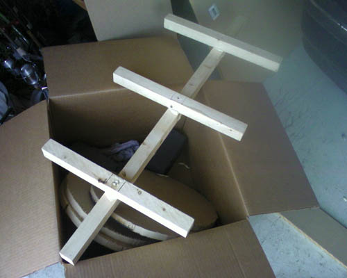

So I created the brace that will hold the box together inside, keeping it from flexing. Don't worry, at this point in time I did a little more bracing than that.
Added the top piece to the box. Pain in the A** when trying to build this box by yourself. And also having no table to work on is a pain.

So now, these pictures were taken on 10/25/06. And at that point in time the box was put together. Heres those pictures.

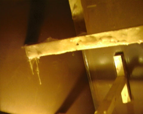

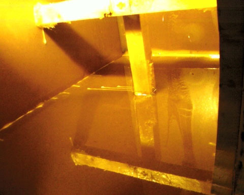

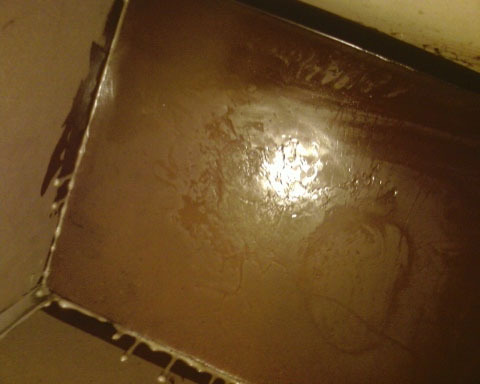

That was the last update. A week or so later I resined inside the box every 90Degree angle there was, didn't really take pictures of that. Today, I poured in fiberglass resin on the flat surface, about 3/8ths thick or so. Pictures tomarrow on that, not sure if thats interesting but I will post it anyways.

NICE ! - i bet its gonna be super loud
3/8" thick resin u say !? - isnt that a bit too much & by u adding so much will decrease a lil bit of ur overall box vol ......

well that was a estimate of how much resin i put in. Probaly its like more or less than 1/8ths.

Todays Update as promised. The resining part of the box. I have one more side to go and about a few more corners to do as well. Enjoy peoples!

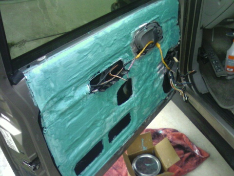

edead install. its only one picture but I'll see sup tomarrow one what I decide to do.

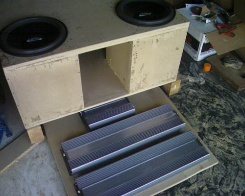

Heres some more progress pictures!

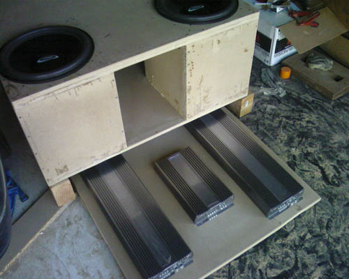

More Progress.

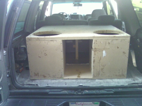

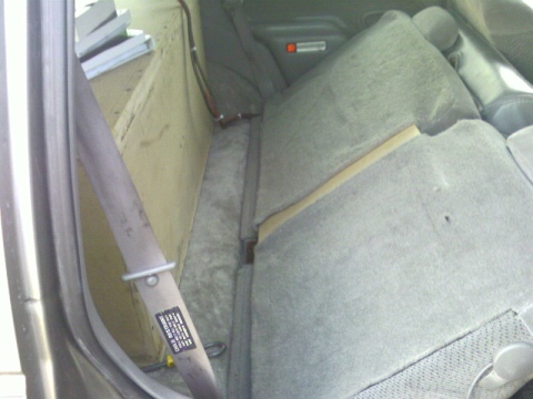

Box fits perfectly into my car. Its goes in nicely and will snug between my panels nicely as well. Also window height length which is really good.

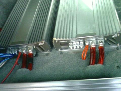

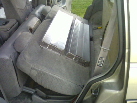

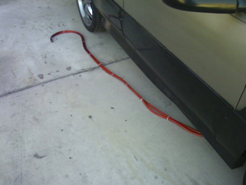

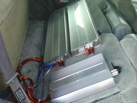

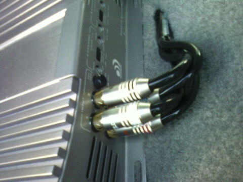

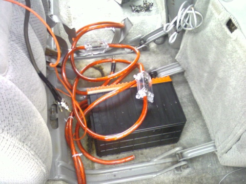

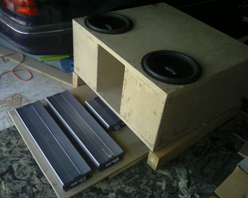

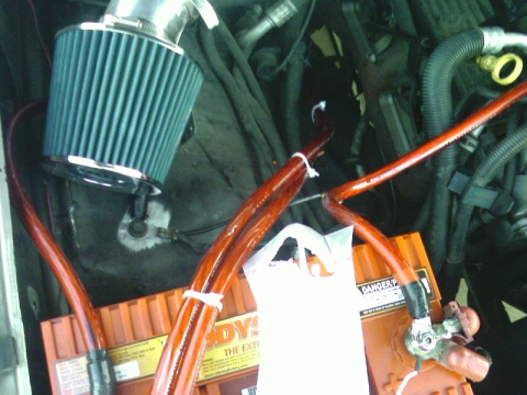

Alright, heres more updated pictures of just some wiring and the amps on the back seats. and don't trip, I cleaned up the wires some, but their so thick its hard to bend them and have them placed how I want it. I'll take more pictures today.
Username: Bernymac
Cambodian
Post Number: 1587
Registered: Sep-04

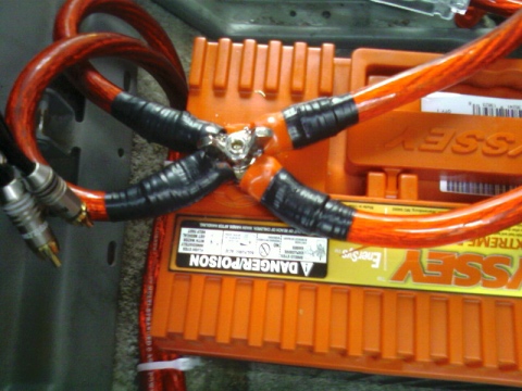

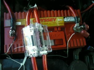

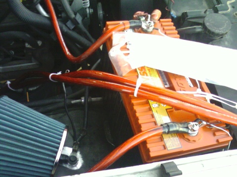

Fused the front batteries.

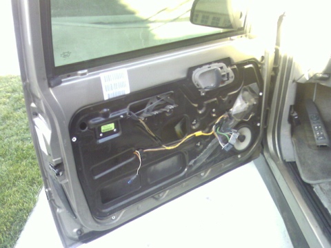

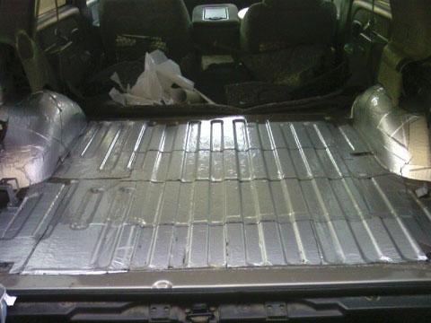

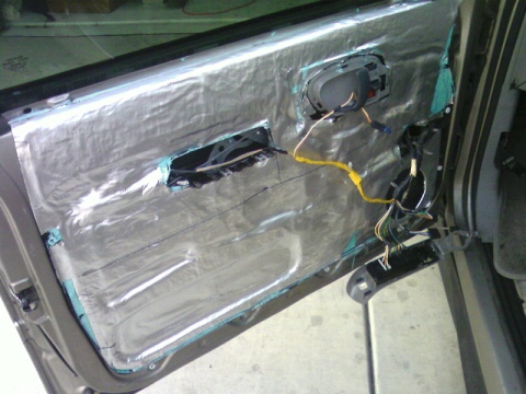

Edeadv1SE^2, then edead v3, then edeadv1SE^2 again.
The doors and comps are the last thing I'm worried about at the moment, more progress on these in the next week or two.

I hate to sound stupid lol, but what kind of subs are those? I was going to guess DD?
Username: Bernymac
Cambodian
Post Number: 1592
Registered: Sep-04
AudioQue HD315

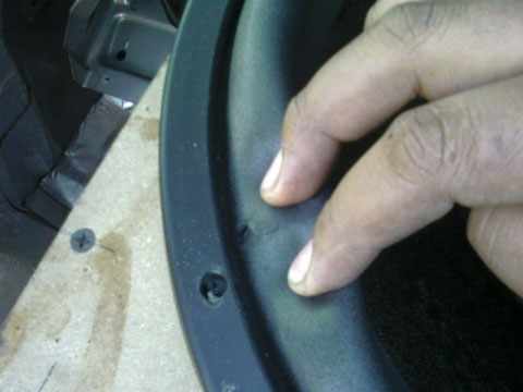

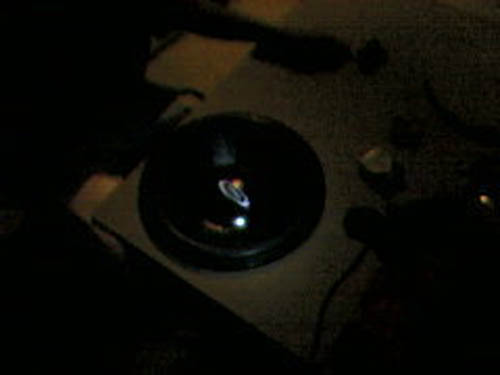

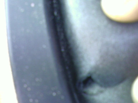

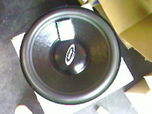

Now to the bad....the holes.eh.

Username: Sploosh56
Ohio
Post Number: 1592
Registered: May-04
put some clear silicone on it. the system looks awesome by the way. that sucker is going to hurt when it gets bumpin'
Username: Tdbdadrummer
Wellsburg, WV
Post Number: 1828
Registered: Aug-05
How'd you get holes in those?

Username: Bernymac
Cambodian
Post Number: 1616
Registered: Sep-04
Resining REPOST:
I poured my resin in, f@ck brushing it on! Chad Lee know's sup with that.

ewwwwwwww good thing the inside of the box isnt there for looks lol that sux about the hole in the sub :-( but nice install

why is there 2 power wires in those amps or is it a power and ground wow what a dumb ? huh lol well it looks lik etheres 2 remote wires in the one amp whats that 4? wow would get lost with trin to hook up a big three with all those power wires i wouildnt know where to start

Connecting power isnt hard, just takes time to run them all through the car\firewall the 2 in the remote i would guess is so he didnt have to run another remote wire so he daisy chain'd it to the other amp, berny.. by looking at the amp... it looks like there are 4 terminals for speaker outputs its mono so i am assuming that thats just for making it easier to run in paralel, are those DVC 2ohm running 1 ohm, or DVC1 running .5?

its called epoxy resin, and its in the paint section. it should be near where the bondo/gorilla glue/wood glue isle. and its not two power wires. one ground and one power. if you looked close enough you can see the black electrical tape to show that its for ground. and like killa said, i daisy chained for the remote. on another note. the subs are dual 4. wire down to 2ohm each, and connected to its own terminal at 2ohms giving them about 1000rms each. the amp is 2ohm stable (bridged). but since the other amp doesn't work. i just hooked it up as you see. the amp isn't 1ohm stable. a lot of people get confused as to why i hooked the subs the way i did. lets just say i know what i'm doing and no! i can not wire it down to 1ohm bridged!! so yeah.

I thought I would update this thing and post up a few more pictures of some progress.
Building a amp rack for the amps and also made a rack that goes under the 2nd row seating to hold the AC EQX and 6XS.

Now to the finished product!
Like this thread says, from beginning to end. And I am far from the end of this whole project.
I will post pictures of my new box in the next day or so. And a few weeks from this post, pictures of my custom door panels, done by me of course.
