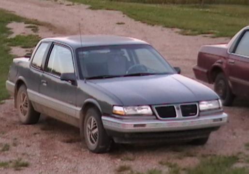

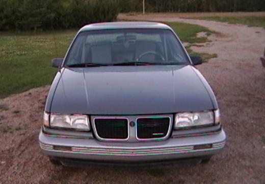

This is my car. Nothing to brag about, an '89 Grand Am:
" " Another:

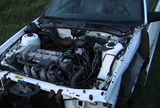

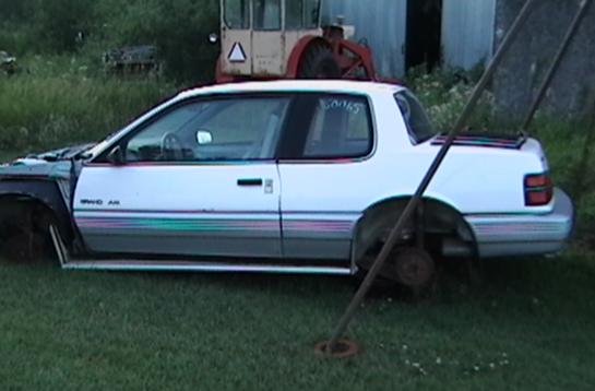

The donor car I got to fix the little rust spots, and for the power windows/locks:
" " Another :

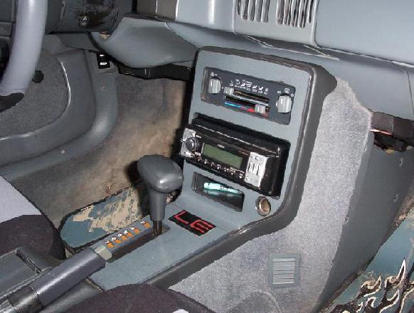

This is my head unit, a Clarion DEH655MP

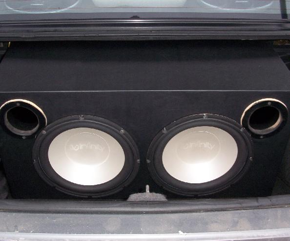

My first sub box, pvc ported tuned to 33Hz but there's port noise (ugh!):

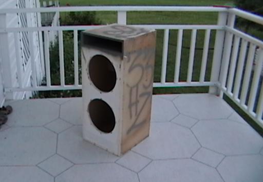

My second box, slot ported and also tuned to 33Hz. I still have to cover it in leather like the first one:

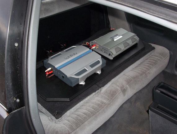

This is when I had my friends Clarion amp in my car along with my old Infinity 310A:

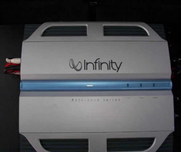

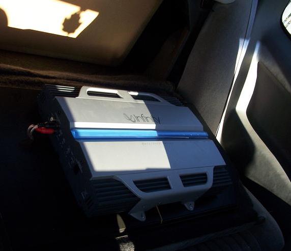

New amp I got a few months ago. Infinity 611A:

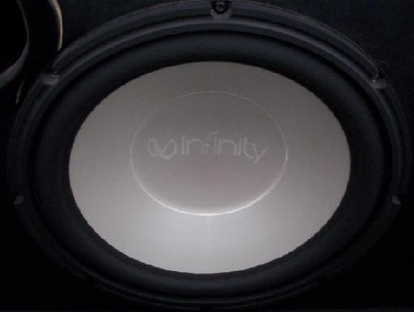

My subs, I have two of these. Infinity 1230:

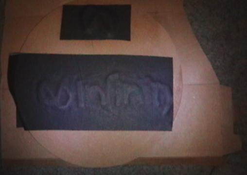

This is what I plan on doing when I cover my sub box. Raise the lettering. This was done quickly just to see how it would look:

See how the seat with the amps mounted folds down and you can see the back of the sub box? I usually drive around that way because it sounds better/louder. I was thinking of using foam to do that raised look under the leather so when you look back at it, it doesnt just look plain like the back of a sub box. The terminals are on the side, out of sight, so you can't see any wires and that amp rack has all the wires ran underneath it. When i get my car cleaned out I'll post more pics, and when I get all the body work done and a paint job, I'll post more. Until then, keep the messages coming. :-)

what size were the tube ports on ur box, and what size was the box???
they look like 2" ports, and they dont look like they are flared, i think thats why u had port noise. not enought port area, and no flare for enter and exit.

Those were 4" ports, and I think the port noise was from the inserts to hide the seem of the vinyl, but it also whistled when it was just painted, and there was a routered flare then too. Its probablly because it wasn't flared at the other end.

i like those infinity subs... good SQ for the money
