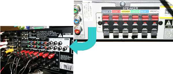

I have a unique problem. I have a home theater receiver and need to connect it to a powered subwoofer. The wiring runs through the walls and is standard pair of monster cable speaker wires (4 wires total 2-left and 2-right). I have a single RCA output plug on the back of the amp for the powered sub, and on the back of the sub there are 2 RCA jacks. If I put RCA connectors on the speaker wires, how do I go from one connector on the back of the amp to 2 on the back of the sub?
Username: Board_lord12
To Jeff Sosa:
Your sub probably has a left/right rca input(2 as you described) so it can output to other speakers (many subs have this). If you are simply connecting your sub to your receiver you only need 1 rca connector (the white one which is a mono signal). Fortunately, subwoofer signals are not stereo encoded so you are not losing any signal.
Basically, all you need to do, is have an rca connector on both ends of 1 cable - 1 end plugged into the sub output from the receiver, and 1 end plugged into the WHITE input on your sub!
Note that if your speaker wire is higher than 16 guage you may not get the most amazing signal in the world, but realistically it is highly unlikely that any human ear could tell the difference.
-board_lord12
