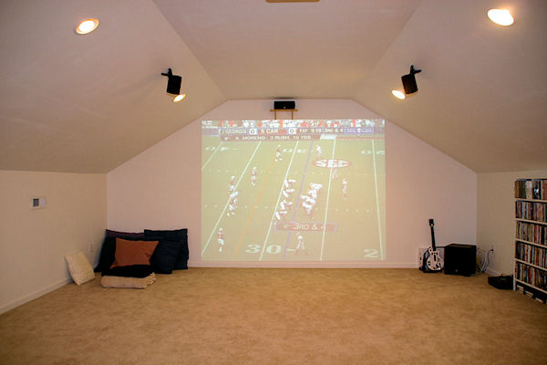

OK I posted this in the wrong area before, not realizing this section was here, so I'll try this again:
A bit about me:
I'm an engineer, and MECP master mobile audio installer, but for home room treatment, I'm a novice. I also do cabinetry so building my own panels and so forth is a preferred option.

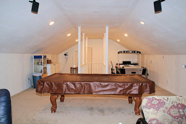

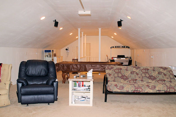

I'd like to find a way to treat the following room, as it's a "bonus room" over the garage of the home I'm looking to purchase. The speakers in the ceiling in the photos are already there, but not my stuff.
I plan to use an Onkyo TX-NR906 receiver to drive:
KEF 104/2 Reference mains
Pinniacle P5.5 center
Polk FXi3 surrounds and rears (7.1)
Energy e:XL-S12 sub
with the center and Polks on stands, not ceiling mounted.
I need ideas for materials to cover the frames with for sound absorbing panels on the angled ceiling and lower side walls etc, ideas for corner treatments, and so forth. Thanks.
In short, I want this room to work well for audio (music 2.0 and AV 7.1) What do I need to do to the room?
thanks for any help!
