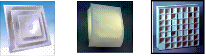

Primitive Root Diffuser
Designed utilizing modulated prime root number theory, the math shows us that the reflected energies will be equal in all the diffraction directions, yielding an even sound redistribution pattern as shown in the above right balloon plot. Its special performance feature is that it virtually eliminates the specular component of the incident sound wave. This means that in terms of creating a sense of spaciousness, while supporting imaging, there is no equal.
1D Quadratic Residue Diffusor
Designed utilizing quadratic residue number theory, the math shows us that there will be equal energy in the diffraction directions, which depend on the number of wells and how wide they are. The bandwidth depends on the deepest and narrowest wells. The scattered energy is in the form of a hemi-disc. The photo to the right shows an optimized quadratic residue diffusor, with nested components for increased performance. One of the most effective diffusers across the largest range of frequencies, these are most often used on the rear wall of theaters and listening rooms when the listening position is not close to
the surface.
2D Quadratic Residue Diffuser
Designed utilizing modulated quadratic residue number theory, the performance of these units is similar to their 1D counterpart, only in 2D! The scattered energy is in the form of a hemi-sphere. Now available in a lightweight expanded polystyrene as well as molded gypsum and furniture grade wood units, this panel technology brings high performance in a low profile – great for applications where headroom is at a premium.
Binary Amplitude Grating
Designed utilizing optimal binary number sequences, this panel technology has revolutionized small room acoustic design. By placing a 5/32” diffusing template between the fabric and fiberglass of a common absorptive panel, an often overused and misused tool in many theaters and listening rooms, this hybrid panel diffuses high frequencies in 2 dimensions, while simultaneously absorbing low frequencies. The low frequency absorption is determined by the thickness of fiberglass behind the template and the depth of the air cavity behind the panel. When the surface is flat, these panels are typically 2-4” thick, which work well in rooms that cannot afford to lose many inches in its length or width dimensions. Upload Also, because it is a hybrid surface, the listener can sit much closer to them without experiencing near field phasing effects. The template that separates the fabric from the fiberglass provides a diaphragmatic mass, which allows it to absorb frequencies much lower than a common fabric wrapped absorptive panel. The panels are now available in a curved profile, which enhances the diffusion and increases the imaging and spatial performance.
Geometric Diffusers
Units like the one shown at right have been around for many years. Other forms that they may take on are trapezoidal, barrel and globular shapes. Since these geometric forms are really re-directors of sound, rather than diffusers, they tend to work better in larger spaces, such as choral rooms, churches and band rehearsal rooms. As they are technically classified as sound redirectors rather than true sound diffusers, you do not find them often in small rooms.
