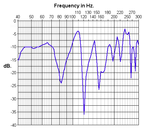

Much more difficult to control - and far less obvious to the untrained ear - are problems caused by reflections at low frequencies, which for these purposes I consider to be below about 300 Hz. Low frequency reflections are responsible for two main problems: One is modal ringing, which is a result of the room’s natural resonances. For a given spacing between a pair of parallel walls there will be a series of low frequencies that tend to sound louder, and sustain longer, than other low frequencies. This ringing makes music sound boomy; thus, it is difficult to distinguish which notes are being played by bass instruments. You can hear that low frequencies are present, but you can’t discern individual notes. This effect is sometimes referred to as “one-note” bass because all of the notes sound the same - muddy!
Another even more important problem caused by low frequency reflections is the severely skewed low frequency response that exists in all small rooms. No matter how much you paid for your loudspeakers, and regardless of their published frequency response, as soon as you put them in a typical home-sized room they will exhibit a series of peaks and deep nulls that extends throughout the entire bass range. Figure 1 shows the response in a typical 16 x 10 x 7-1/2 foot room that has no acoustic treatment.
fig1
Figure 1: This terrible low frequency response is quite typical in small rooms.
This horribly skewed low frequency response is the result of bass waves bouncing off the walls, floor, and ceiling, then combining with the direct sound waves still leaving the loudspeakers. At some frequencies and locations in the room, the reflections combine with the direct waves more or less in phase, which creates a peak in the response. At other frequencies and locations, the waves may be out of phase, and that creates a null. Peaks are usually less than 6 dB, but the nulls can be extremely deep, depending mainly on how rigid and thus reflective the room surfaces are. As you can see, nulls can easily be as deep as 30 dB or even deeper, especially in the middle and upper bass range above around 70 or 80 Hz.
At very low frequencies sound waves tend to pass right through most walls, which is why you hear mainly thumping in an adjacent room. Standard sheet rock walls also tend to absorb very low frequencies as they vibrate in sympathy. But the higher bass frequencies are reflected instead of being passed and absorbed, and this is the cause of both modal ringing and a skewed low frequency response in the mid to high bass range.
I consider nulls to be more damaging than peaks because they can totally obliterate bass notes. In Figure 1 the very large dip at 82 Hz corresponds exactly to an E note on a bass instrument. If an electric bass is playing that note, you will hear no fundamental tone at all - only the second harmonic an octave above. However, the second harmonic at 164 Hz is also in the middle of another deep null. To my way of thinking, the total and sudden absence of any bass note is a serious problem, and is far more significant than a few dB boost that merely adds a little fullness. Further, most rooms have a large dip somewhere between 80 and 120 Hz right at the listening position. Many people first notice this as a severe lack of bass that goes away when they walk away from the couch.

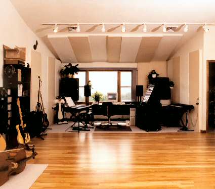

Another, more popular type of resonant bass trap is the membrane absorber, often called a panel trap because it uses a front panel made of thin plywood or a similar material. Panel traps also use fiberglass to broaden their range of absorption, and when designed well they are effective over a range of about an octave. This is still not ideal, but it’s broader range than a narrow band Helmholtz absorbers. When panel traps are used to treat a room, two different types are usually built - one having a center frequency of around 100 Hz and another centered at around 200 Hz. This yields an acceptable amount of absorption in the important bass range of 80 to 300 Hz. Although, not as cumbersome and difficult to build as Helmhotz resonators, they are still large and bulky, relatively expensive, and require a fair amount of labor to build.

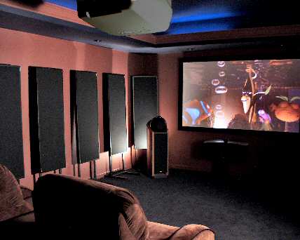

In my opinion, the best type of bass trap for most rooms is a broadband absorber based on rigid fiberglass. Rigid fiberglass is similar to the fluffy type used for home insulation, but it’s compressed to about one quarter its original thickness and formed into panels one to four inches thick. A three-inch thick panel of rigid fiberglass is therefore about as absorbent as regular fiberglass one full foot thick. The overwhelming advantage of rigid fiberglass traps is they’re not based on resonance so they operate over a much wider range of frequencies. Indeed, rigid fiberglass panels are commonly used to absorb mid and high frequencies too. Even higher performance can be achieved by combining rigid fiberglass with a membrane. Such a hybrid design can achieve very high absorption over a wide range of frequencies, often down to 80 Hz and even lower.
It’s difficult to get substantial absorption below about 80 Hz using a fiberglass-based trap. Fortunately, as explained earlier, most rooms don’t need much absorption below 80 Hz because sheet rock walls pass and absorb those very low frequencies. So unless you have walls made of cement or block, or have two layers of sheet rock for increased isolation between rooms, fiberglass bass traps are an ideal choice. Further, a parametric equalizer can be used to minimize resonance or modal problems at the low frequencies. You should always try to minimize bass problems passively, with a combination of speaker and listener position and appropriate bass traps before using a parametric. However, there may be practical limitations in the room, whereby you can not put in as many bass traps as you would like, or you may not be able to move the speakers into their optimal position. In cases like these, parametric equalizers, are ideal.
fig3
Figure 3: This is an example of commercial bass traps that combine rigid fiberglass with a membrane for enhanced absorption at low frequencies. This particular design is effective down to about 50 Hz.
Absorption panels meant to tame mid and high frequencies are generally fairly thin, and they can be placed flat on the walls and ceiling where they intrude very little. However, bass traps by definition need to be fairly large, or at least thick, and they are most effective when placed in or near the room corners. You can definitely have too much absorption at mid and high frequencies, which results in a room that sounds lifeless and sterile. But it’s probably not possible to have too much absorption at low frequencies. As more bass traps are added, the low end continues to become tighter sounding, and the low frequency response gets flatter.
