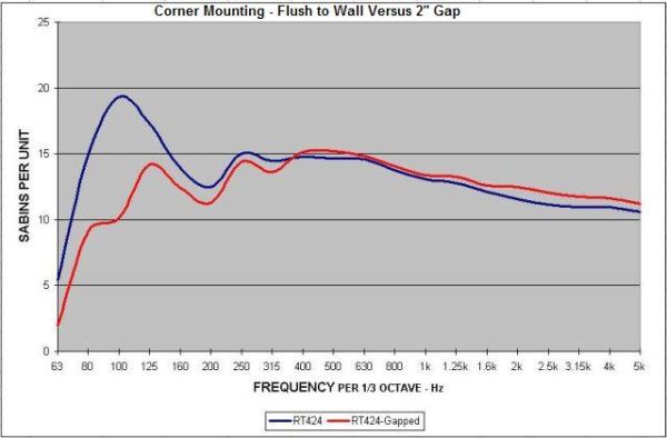

Also as explained above proper placement yields better perforamance. Here are lab measurements of the Ready Acoustics RT424 [a 4" thick upholstered bass trap with a OC703 core] . In one instance the panels is placed in a corner with the backside edges touching room boundaries [wall/floor or wall/wall]. In the second case a small gap [about 2"] is introduced separating the panel from the room boundaries. Notice how the absorption peak between 60 and 100 Hz collapses.
Conclusion: placement is important.
more details on this suite of tests here:
http://www.readyacoustics.com/index.php?go=acoustics-advice.acoustic-data
