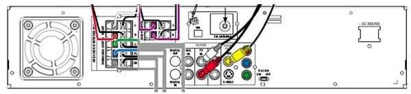

Hello, I have a old style PS2 and my Surrround sound setup is a Philips MX 5600D( http://www.usasupport.philips.com/productDocuments.html?ProductCode=MX5600D/37&subCat=HOME_THEATER_SYSTEM_DVD_SU_US_CONSUMER ) I would like to halve 5.1 channel Surround while playing my PS2. heres the dilemma, I bought the digital optical cable, but my setup doesnt have that input. The way I have it setup now is I hooked my TV up with Red and White RCA cables to the back of my amp. and I play PS2 through that sound, but on the back of my amp it has inputs/outputs for Digital. What is that? Can I get some sort of adaptor or anything to use it with that? here is a pic of the back inputs, If you cant read it click on the PDA on the main page of my stereo.Upload

No. the thing is there is no Optical port on my Amp. only the PS2. There is a "Digital" input and output on the back of my amp it is located in the bottom-middle-left They are the RCA *STYLE* PORTS.. Look at the picture. It is 2 spaces to the left from the RCA cables in the picture. Is there some type of adaptor that plugs into one of the ports and the other side of the adaptor has an optical input?

http://www.audioshowcase.com/specs/10tr-08300.htm
I think that is what I am looking for.

i don't know if any are under $20 but that should meet your needs. it changes optical to coax and the one on your reciever is coax. if it doesn't work then the converter is faulty.
