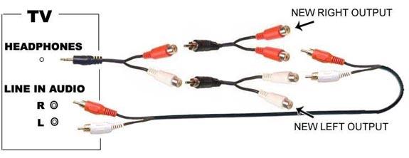

for the ppl who are having the problem with the tv, is you do not have a RCA output on it, go get a cheap VCR. or a adapter of some sort. and hook the coax's from the vcr to the tv. then use the audio outputs on the vcr to go into your amp/receiver. but the only problem u will ahve is that a vcr, has only one cannel ouput. so unless u wanna hook all ur speakers up to the right front and right back channels on ur receiver, its not gonna work ur was, it might not help you, but in some cases a VCR is cheaper than a new T.V :-)

If the TV has red & white audio out connectors and the stereo has the same for input (marked as AUX perhaps) use a stereo interconnect.
If the TV has a headphone socket, and the stereo has red & white audio out connectors for input you can use a stereo 3.5mm jack to stereo RCA connector.
If the TV has red & white audio in connectors and the stereo has a microphone or LINE in socket, use a stereo 3.5mm jack to stereo RCA connector.
If the TV has a headphone socket and the stereo has a microphone or LINE in socket, use a stereo 3.5mm jack to stereo 3.5mm jack connector.
HTH :-)

Username: Clos69
El Paso, TX
My TV does not have an output and everyone says the only way to do it is by connecting an RCA adapter to the headphones jack but I want to keep my built-in speakers. I've drawn out a plan on photoshop as to how I might be able to get what most of us are asking for but I want your opinions. Will this work? I haven't tried it because I don't want to ruin anything although I don't think it should.
Here's my idea...
Please comment on it. Thanks
Username: Clos69
El Paso, TX
I think you need a headphone amplifier or else you're going to have to raise your volume more than usual. By the way, this didn't work. Well it works if you don't want to use your built-in speakers and don't mind turning on the stereo everytime you want to watch tv. Me, I don't like to watch the news with a surround and don't want to turn my tv to unplug the headphones jack everytime.

Yes, you can use Tape 2 or LD/DVD Inputs.
Username: Huckle
So the other end should be connnected to the DVD player outputs? This does not give me sound from stereo. Maybe this is just not possible.
Username: Project6
Post Number: 10443
Registered: Dec-03
Yes. Then go to the DVD players set up menu and configure it to output stereo and not digital output.
