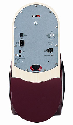

Each XdS speaker is bi-amplified with 150 watts dedicated to the 5 1/4-inch mid-range, and another 150 watts dedicated to the 1-inch neodymium tweeter. Each XdW subwoofer has two 10-inch drivers powered by a 500-watt internal Class D amplifier.

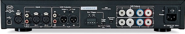

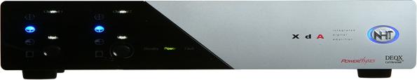

NHT's proprietary workhorse is the XdA. In one slim box it has a DEQX-calibrated DSP (digital signal processor) and PowerPhysics One-Cycle Sound Class D (4 x 150-watt) amplifiers. Each XdA powers two speakers, and connects to one or two XdW subwoofers. In simplistic terms it optimizes the signal before it's sent to each speaker. However, a technical explanation is available here.
Four speakers in one
Despite the complicated aspects of the XdA, it's quite easy to control. Its front panel amp has just one button to press for each speaker channel, which correlates the position of each speaker connected to it. The four options are:
  1. Near a wall
  2. In a corner
  3. On top of a TV
  4. Away from walls
Once set, you never have to touch the XdA again. Each speaker channel is set individually. They don't all have to be set to the same option. The XdA corrects the signals sent to each speaker based on the setting selected, essentially changing the sonic characteristics of each speaker. The point is, your system can still sound incredible even if any of your speakers have to be placed very close to a wall or on top of your TV. Although, ideally all speakers should be placed at least 2-3 feet away from any wall. The "speaker correction" processing allows greater compatibility with any room and provides more flexibility in speaker placement, which interior designers and spouses generally appreciate.

The most confusing part of the setup involves configuring the preamp. It's very important to set the main (left/right) speakers to "Large" and set the subwoofer to "None" or "Off". This may sound counter intuitive since the speakers are definitely small and you do want the subwoofer to work. The XdA does all of the processing and turns a XdS (speaker) and XdW (subwoofer) into a three-way speaker, despite being housed separately. Using the "Large" setting insures the XdA can process a full-range signal. If a sub is not connected to the XdA then the "Small" speaker setting should be used for that channel on the preamp.

Once I confirmed all settings to be correct, you're left with one final variable -- where to place each XdW subwoofer. Finding the best location for each subwoofer ended up being more time consuming than anticipated. After much trial and error, I discovered placing a XdW right next to any XdS speaker was better than the typical corner subwoofer placement. Getting the subwoofers placed correctly was very important and made a dramatic difference. It should be noted the XdW bass output is limited to 25Hz and above, so it doesn't play extremely low, couch shaking bass. I would have preferred deeper bass, but the XdW provided clean, detailed, and tight bass that was a welcome alternative.

Both the XdW and XdA had problems with their power saving auto on/off features. The trigger switch on the rear panel of the XdA is set to "Audio" by default, which is supposed to automatically power on/off the amplifiers whether or not it detects an input signal (sound). The XdW is set at the factory to auto power on/off. However, on multiple occasions any one of the XdA's or XdW's would shut themselves off, which occurred mostly while watching TV at low to moderate volume. Adding to the annoyance was a brief crackling noise heard through the speakers when the XdA first turns on. NHT said the turn-on noise was normal.
Power fix
Fortunately, both power settings can be overridden. On the XdA, simply set the rear panel switch to "On" (always-on) to prevent inadvertent shut-offs. Fixing the XdW's factory preset power setting involves a much more complicated process of unscrewing the rear panel to switch a jumper on a circuit board.
