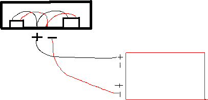

I just installed a my old sub system in my car and had to buy a new amp becuase my old one was fried. Anyways, when I hooked it up, it was not as loud as my old system which I was running bridge. My old amp was a 100 x 2, my new amp is here [url]http://www.kenwoodusa.com/product/product.jsp?productId=2482[/url]
What I need to know, is if the following sub layout is the best setup for this system? Am I getting the most out of the system.
Here is the layout.
[IMG]http://img.photobucket.com/albums/v47/Punchy1/sublayout.jpg[/IMG]
If this layout is not ideal, what should I do to get the best results. Please review the amp url. Thanks again.
Sorry about the art skills....Upload

If those subs are svc 4 ohm or dvc 2 ohm that will make that amp run at 2 ohms and you will get the most out of that amp.
