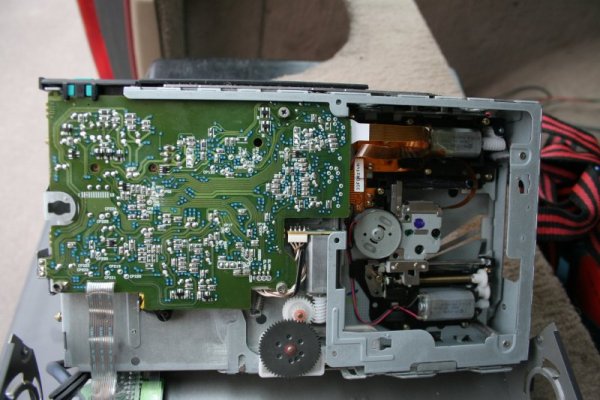

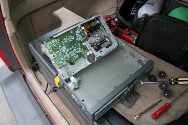

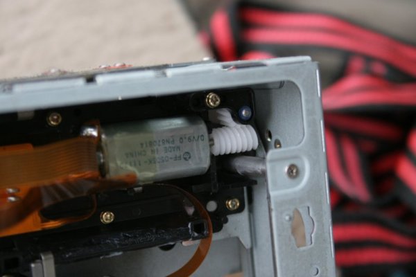

Hi. I recently had this problem of a jammed worm gear, which was preventing the loading mechanism from operation (although the CD cassette could be loaded/unloaded OK). If you are happy with a screwdriver, it's an easy thing to unjam the worm gear. I also tightened the screw which holds the gear mount, but it was not really loose; have changed CD a number of times since fixing with no problem, but I suspect this may not be the last time it happens. I have also posted some of my own photos for you right here.
Username: Tomba
Registered: Apr-06
Here are the images:
unit removed from case
underside showing worm gear at top right
close up of worm gear

The solution posted by E worked for me. Thanks to Tom Fuke for the pictures.
