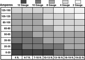

No its not disconnected. Its a straight wire from the Newly Alpine Amp (previous phoenix gold) to the Eclipse.
I talked to the guy a few minutes ago and he said that a distribution block is not needed as long as you are not running no more than 80 amps and if you were running less than 18" of wire. He said he used 8 guage wires.

He's wrong. Look at this power chart:
8 guage is not going to supply anywhere from 65-85 amps in runs longer than 13 ft, which your car definately is using at least 13 since it's a Passport. You need 4 ga. wire and a distribution block, then 8 ga. to each amp, and ground the amps individually.
