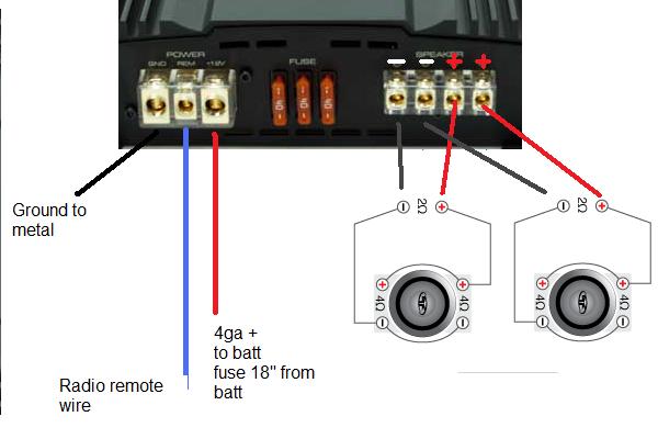

What size wire do i need? Im having the AQ1200d powering 2 12" RE SE subs. Approximately how much power will i be putting to these subs? I got the 4 ohm subs. Do i need 4 gauge wire 2 gauge 0 gauge 00 gauge...just wanting to know.

if you wire each sub to 2 ohms ( red to red, black to black) then bridge them to the amp they'll be at a 1 ohm load, 1200 rms, depending upon what your car's voltage stays at. As far as size wire, you can use larger but standard wire would do fine. If you want thicker wire but don't want to buy a giant roll of it, you can go to lowe's and they'll sell you it by the foot.

if it takes 4 use 4 if it take 1/0 use 1/0
and use 16-12 for Speaker wire
wire it to 1 ohm
like the top pic in this link
http://www.rockfordfosgate.com/rftech/woofer_wizard.asp?submitted=true&woofer_qt y=2&woofer_imp=4

honestly i'd run 1/0 .. then a short run of 4awg from a distro to the amp

Username: Southernrebel
Monroe, Louisiana
Team Audible...
Post Number: 7758
Registered: Mar-04
There you go, all you will be missing is the RCA's to the Hu.

Im from Shreveport. That helps now dont i need to buy another fuse then? i will have to put another one on the wire 18 inches away from the battery? is that what that is telling me? I cant wait.....I have some wire laying around. Ive got all kinds of guages and everything so i dont think ill need to buy anything....well im going to need a new head unit but thatll be around christmas.

Yes, you will need a fuse holder next to the battery. No more than 18" away. Make sure you use a gromet then you go thru the vehicle's firewall w/ the 4ga wire...and make sure it is true 4ga wire. If you have high strand count welding cable, that will do fine.
Ground wire should also be 4ga, use a good ring terminal (well crimped or soldered) and remove all the paint from the metal on the vehicle where you ground. A few self-tapping metal screws will do the job. Keep the ground wire shorter than 3ft.
