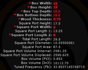

ported box for 3 12 inch alpine type r's
hight -- 18
width -- 43
depth -- 18
tuned -- 32
port height -- 16
port width -- 4
port length 1 -- 13.25
port length 2 -- 4
any and all input would be great.
thinking my port should be bigger but im not too sure.

whats total volume of the box? and how much square port area?
Username: Tejcurrent
Post Number: 1955
Registered: Apr-07
I came to about 6.54 before port. I'd do a bit more port area if possible- try 16x5 internal measurements.
Using that port area I'd figure your port length and adjust back up to around 6ft net- depending on the power and setup- you didn't really mention all that.

i would do something like this:

Jones; yeah sorry about not mentioning what the setup will include. ill be runnin 1 pdx 1000 and 1 pdx 600 to the subs & the box is going in the back on an ext cab.
&+ thanks bassman

one more thing, about the demensions.. on the lower left, you know how it says
box left plate: 18.25 x 17.5 x 18.25 x 17.5
and
box right plate: 17.5 x 17.5 x 17.5 x 17.5
why are those different?
shouldnt the left and right sides of the box the same?
please help me get a grasp on this shiitt thanks

"box left plate: 18.25 x 17.5 x 18.25 x 17.5
and
box right plate: 17.5 x 17.5 x 17.5 x 17.5"
(its correct its taking off the thickness of the wood) its because its how they connect to each other

Bassman, think you could get me the specs on the RD cal like you did before but this time for 2 type rs not 3, thanks bro
Ducka, thats what i was plannin' on doing

my computer is not working to well for some reason.
do:
37 wide
18 high
16 depth
port width = 3
port length 2 = 7
gives you a box around 4.2 @ 32
