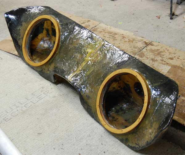

2. The subs, gawd... all that time and effort haha. I made the box completely out of fiberglass (first time) and made sure to quadruple layer the sh!t out of it to avoid any resonance problems. It's solid, weighs a ridiculous amount. With the two (shallow) 10's in it I can barely lift it myself, it's a struggle anyway. Each chamber is .5cu ft. as called for by the specs when using the subs in a sealed enclosure. I stuffed in as much polyfill as I could without compressing it too much... I think I used 10 oz or a little over half a 'bag'. Initially the two subs shared the same airspace via a small channel but with the dismal sound output I wondered if there was some cancellation going so I dropped in a divider to separate them and sealed it up. No change.
The subs would jump in and out to the point where I could hear the voice coil smacking the magnet as clear as a bell, but there'd be no sound. It was as if the subs were hanging in free air. There are no air leaks. I'm not sure if the box volume is the cause, maybe the subs were DOA, the cabin in the car is too small, the subs are too close to the seats... I dunno. I'm stumped.

Here's a shot of the box after I cut a hole in the top to drop in a divider. This was about 4-5 layers of glass at this stage... I put 3 more layers of heavy glass on after this.

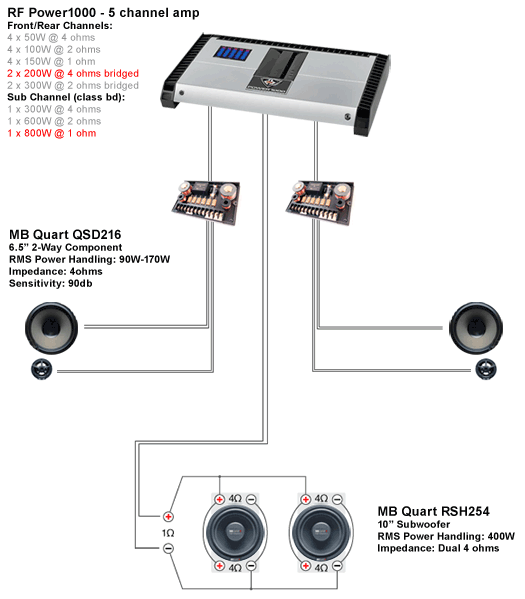

The wiring is as follows....
Nice drawing but that's about it haha..... maybe I have it tuned incorrectly but I don't think I'm (and all my pals) are that inept. You never know though... =] Any ideas?
