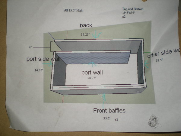

Next week i have an install with 2 Atomic AP15s and an Atomic 2200.1. They recommend 4 cubes per sub and 34hz. Anyone have and tips on how much area the port should have. Right now i have it with 72sqin...Ths is going in the back of a chevy 1500.

what is you goal(daily driver or mainly spl)?
Username: Yukhui
4 15 AA Havocs, Memphis 4kw!!
Post Number: 1005
I believe these were my plans on my single AP 15 build.

on the atomic website they have rec specs ...
Username: Mmaudioconcepts
Post Number: 642
Registered: Jan-07
they do have specs on the site but with my experience in the past when you call them and tell them u have virtually unlimited air space and tell them your goal they give u specs that are not on the website. I just wanted to see what other people have been successful with
