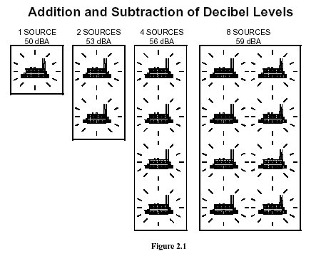

Here's a good pic describing the concept. By adding drivers it's just like adding power, but not doubling output, only increasing it "slightly". Hope it helps.

To gain 9dbs you need to either have 8X the original power or drivers.
Say you start out with one 100w sub hitting 100dbs.
103dbs requires 200w or 2 100w drivers.
106dbs requires 400w or 4 100w drivers.
109dbs requires 800w or 8 100w drivers.
