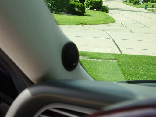

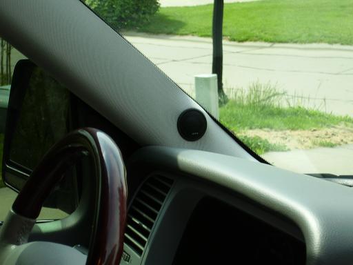

I like the A Pillars.
I fiberglassed mine in and then wrapped it in a mesh material that matched the interior.

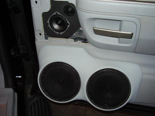

jake that looks really nice but no way i would do that. its to high man. i tried my tweets all over and right above my 6.5s sounded best to me.
i think i have a pic
Username: Deadrabit
Marionville, MO
Post Number: 1151
ok i don't have a pic its on my flash drive and id on't want to go outside ot my car.
its like an inch above them facing at an angle up. like the drivers side tweet is facing the pasenger and the other side facing the driver. i really could tell a difference when they were higher. it was almost like the sound was not as clean.

"jake that looks really nice but no way i would do that. its to high man. i tried my tweets all over and right above my 6.5s sounded best to me. "
Thanks for your expertize BLK but i actually have a tweet down low as well. To tell the truth my front stage system probably took longer to tweek/phase than your entire system did so be careful before you jump to conclusions.
