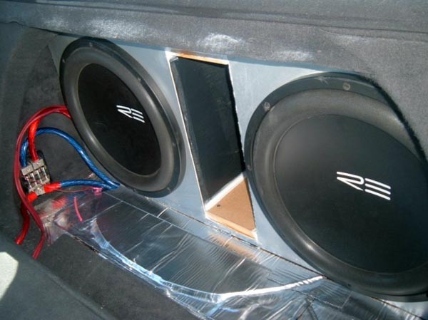

Username: Frkkevin
Team DLS
SuperNatural...
Post Number: 6003
you said earlier 58" inches of port .. you did not mention that was the PORT AREA ... and thats not enough for a 5 cubic foot box
minimum i'd run in 5 cubes is 80 square inches
i would turn the subs/port and fire them directly into the cabin..
build the box big enough to almost seal it off from the back of the trunk.. have the seat folded down and subs/port firing through
sub on each side and port the middle .. design the box so that whatever the width of the port is.. is would be that same dimension from the back of the box.. this way you have a straight port.. not one that looks like this
_| |_

Username: Frkkevin
Team DLS
SuperNatural...
Post Number: 6005
that setup i showed you was two RE SX 15"s on 3600rms.. would burp a 151.6dB @ 49hz on a TL out of the trunk
best bet to get trunk cars loudest is seal off the trunk away from the cabin having everything fire in.. the less volume you have the louder it is going to be.. if your filling up the trunk and cabin thats a lot of volume vs just the cabin
you could fire two 15s forward.. they would need to sit slightly back and you'd need to run two 6" aeros slightly outside of the box far enough to clear the subs excursion.. might have to cut the trunk opening a little bit to get the box in as i had to.. but you gotta make some kinda sacrifice
i ran my xxx firing up and port through the portion of my seat that folded down in my recent car.. i would not suggest firing a sub up in a trunk.. its not good unless you want to rebuild your rear deck under the window.. or port it

tck, 9 cubes externally isint 7 cubes net ported and 7 still aint enough for 2 15's. i can properly enclose 3 12's or i can cram 2 15's its only slightly more cone area but i would imagine a proper setup will always out perform a crammed one.
kevin ive had the 5 cube box in my car before sealed off from the trunk with towels just for a temporary setup and i like the way it sounds facing back better. its not louder but it sounds better. it wasnt out of phase either because i tried that.
how do not bottom out your sx's on 3600 rms?

those SXs you saw in my pictures was running in 5.6 cubes after displacement and had no issues.
i built the box as big as i could to fit my trunk.. i literally had no trunk left

so i sold my sx's and im getting a SINGLE 15" loaded BTL. my friend is gonna design me a high efficiency box possibly with a kerfed port. should bang pretty good on 3200 watts. he swears it will be better than my pair of 12's, well see tho.
prob not gonna have this done until the summer cuz i gotta go back to school on thw 18th and i may ot have time to build the box before then.

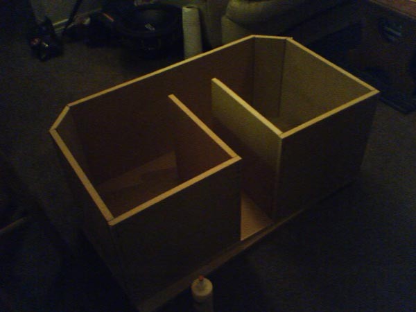

so my friend came up with a plan but it wont fit in my trunk. he gave it 4 cubes net with 150 sqin of port area.
wouldnt i be better off doing 5 cubes with a slightly smaller port area?

Yes its a 4th order design.
kevin its bigger cuz the port area is HUGE almost 3x the area of my old boxes so the external dimensions are quite a bit larger than for my 2 12's
on fi's web page it recommends 3-5 cubes for the btl thats why i was wondering.
i didnt want to build a new box for my 2 12's cuz ive already tried 3 boxes (one was under spec and i knew it wouldnt be good) and havent been happy.
its not a big deal i got a NEW loaded btl for 387 shipped and paypal. plus i just sold my used sx's for 350 to a local dude. and he wants a custom box for $120 so im makin out ok. as long as this btl dosnt disappoint me.

ok so i made my own plans for a box and im going to run them by my friend to see if he approves.
5 cubes net tuned to 34 hz with 120 inches of port area. is this a good design or should i change something.
box and port are going to be in upward slanted wall facing forward behind the rear seats which fold down. the box will be sealed off from the trunk so all the bass will stay in the cabin.
in case you guys forgot its for a fully loaded 15" btl on 3200 rms going into a 2000 chrysler 300m (dodge intrepid)

"ok so i made my own plans for a box and im going to run them by my friend to see if he approves.
in case you guys forgot its for a fully loaded 15" btl on 3200 rms going into a 2000 chrysler 300m (dodge intrepid)"
can anyone besides ben confirm this to be good?
