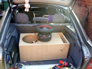

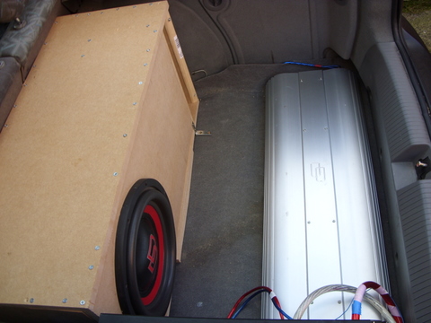

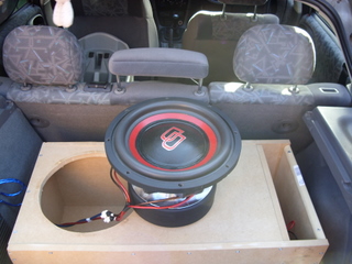

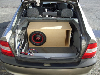

Hi Guys I am new here. I recently got a dd9512g with the composite cone running off a z2 amplifier.I run it at two ohms Cause I am not sure if I have enough power in the car to run it properly yet. I don't do spl, just pissing about over town listening to loud music. When I turn the sub up, the bass will be clean but after about two songs, I will get a smell similar to wood burning. Doesn't smell electric at all. It def comes from the sub cause I can smell it in the port vent. Also will the z2 amplifier cut out if it doesn't get enough power?Both are brand new. Thanks in advance

Gains, bass boost. Sounds like the coil frying.
Holy moly do the screws in your box need spaced out more evenly lol.
Nice stuff though.

Thanks lol. I had four hours of daylight to build the box and install the stuff and it was pretty much touch and go for a 250 mile trip home after that. I am seeking some box designs as I am only using this one for testing purposes, thus no acoustic carpet and bad wiring. I am planning to rip the bottom of the boot out and replacing it with 3/4" mdf and work from there. Thanks for the reply though
