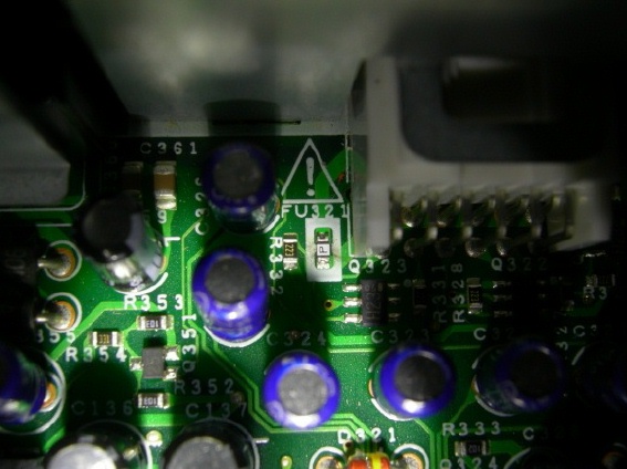

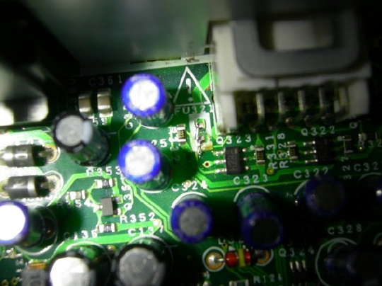

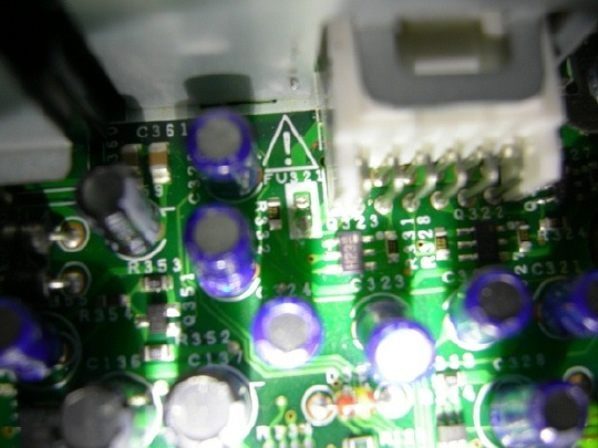

I did the same thing Chad. And it sucks.
But mine just touched the backing on dynamat.
I think it smoked the pico-fuse in my 860mp.
Username: Adddisorder
Palm Beach, Florida
Post Number: 6306
hey canaan i know how to fix the 860 if you blew that fuse. if you want to give it a try PM me and ill try and explain it.

You blew the fuse on the RCA ground side, posted about this before... Polo.
Palm Beach, Florida
Post Number: 6309
yeah thats the fuse i had blow, i fixed it and the noise was gone. i tryed the rca grounding and a new HU ground and all that stuff and it didnt get the noise out till i fixed the pico.

Honestly Chad reading your post above again you got the whine from touching speaker wires together, that probably wasn't what did it. If it uses a Pico fuse it can happen by just "Hot Swapping" the RCAs. That is removing/rehooking RCAs while the HU and amp is on. Another is if the amp for a split second lost its ground, it would try to feed off the RCA ground thus blowing the Pico. By crossing the wires it would only effect the output stage of the amp and if that went and wasn't caught in time then it would attack the power supply section. Think real hard you probably did something else...Polo.
