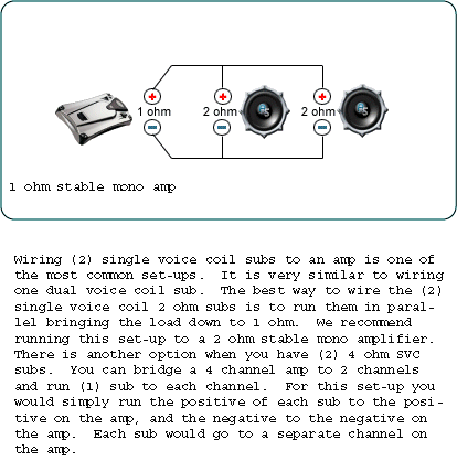

2 single 2 ohm jl w3 12's, waht are ALL the wiring options i have

Wire in series for a 4ohm load. If you have a 2-channel amp then just wire each sub to one channel, if your amp can handle it.

yeah thanks for the website but that doesn' really help me cuz rockford doesn't have any single 2 ohm subs, can i run this at 1 ohm, or 4 ohms bridged on a 2 channel??

Yes you can run it at 1ohm, as long as the amp can handle it.

alright then thanks alot paul thas all about i need, rockford t5001 here i come i suppose
