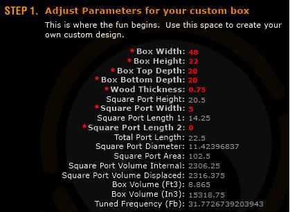

ok with the dimensions you gave me, you can make a box this size.
8.865 cuft with 102.5 sq inches of port area. it will be tuned to around 32hz. since we have a lot of volume to work with, your box is able to achieve the desired tuning frequency without the L bend. no L bend = less turbulance. :-)

wow you need that much airspace for those subs
Diamond Member
Post Number: 21156
we could make it smaller sean but 4.3cuft per sub is cool.

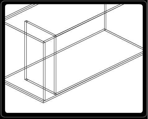

wow thank you chad. i was thinking of the amp rack behind the seats? but your idea works too. What the diff with port in the middle or one port?
Diamond Member
Post Number: 21157
not sure about difference but i was thinking of putting the port on the driver side.
we can do middle too if you like. its just if we do the port along side one of the walls, its easier to add length to it if you want it lower tuned.

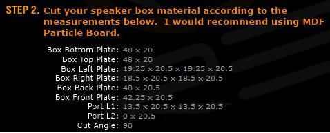

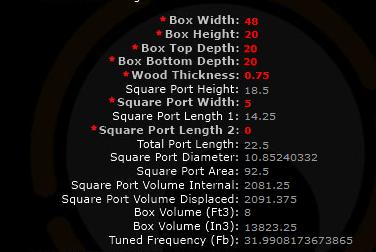

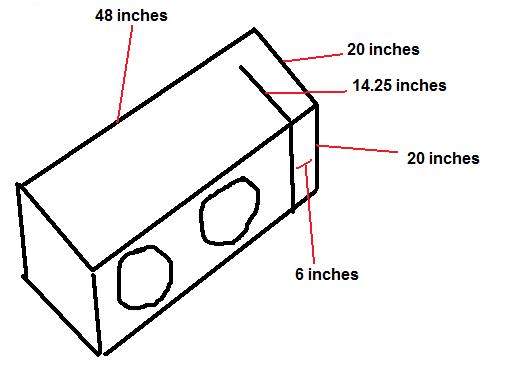

ok after sean's comment, i got to thinking. i think we are getting too greedy with the volume of the box. so i decided it should be a tad smaller. it comes out to 8 cuft. with the driver displacement it will be a bit smaller than that. i think it would be better like this.
as you can see, i shaved off 2 inches from the height.

Chad does this look right?Upload

when you get it cut, remember the thickness of the mdf is .75 inch.
