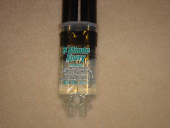

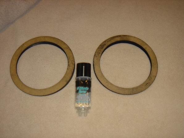

ok you epoxy pros answer a few questions for me. please.:-)
i read the label and it says it will bond everything. well the rings are mdf and the surface will be plastic. so i am pretty confident it will bond.
question is, you think it will be strong enough to hold the speakers up? also during hot summer will the bond get loose?
as you can see in the pic below, i have the 5 minute epoxy. should i get the 30 minute epoxy so i have more time to work with?
should i sand the plastic surface before appying the epoxy?
thanks in advance.

sand and use alcohole so there is no oils from armor all remember chad. I would also get some type of clamps to clamp them down while they are drying.

that may nor hold as there is specific epoxy for plastic i would use a rubberized ca like ic2000

so you are confident they will hold berny? also those rings are the angled ones:-)

Use the epoxy to TEMP hold the rings to the plastic. Afterwards use a mixture of fiberglass chop/polyester resin on the outer of the ring joining the plastic. I encountered this problem when modifying my Q-pods which are plastic. You need to sand the plasic well in all directions, don't just go up/down or in circles do it in all directions with a 60 grit then use rubbing alcohol and an old clean towel to wipe the area down. Polo..

Oh these are for the outer? Do you have a lower ring below the plastic? You know there isn't enough meat at the thinnest point on that ring to secure the speaker. polo..

Drill holes in the thickest parts of the ring for screws. Add a little 20min epoxy under ring use the screws to secure to lower ring (below plastic. Be sure they are countersunk, once hardened mount the speaker but don't use real long screws for the speaker. Also remember longer the epoxy takes to harden more tensile strength it had (IE- 20-30 min is stronger than 5 min) Polo..

yeah polo the thin part don't have enough meat. lol. that is why i want to use epoxy and not screws. i tried using screws and i split so many rings.

Hey Chad listen up, drill holes larger in the ring that will allow the speaker hold down screws to pass through the top ring. As you bolt up the speaker it will hold the angles ring down. I did the same thing and used a clear adhesive/sealant between the thin top ring and plastic layer. I am not using the adhesive to hold it down but to keep in place and seal. Polo.

Here is another... Take your angle ring and find say about 4-6 wood screws that would fit comfortably within the dia of the wood ring without compromising (sp) the wood integrity (sp). Once you find the hardware find a drill bit to match the dia of the head of the screws. Drill down until you have reached say 1/2" before you go all the way through maybe a tad more. Now get a bit to match the dia of the fastener threads drill down the center all the way through the angled ring. Be sure to round it out a tad to allow the fastener to fall all the way through so not to grab the top ring when tightening. this will allow you to fasten the top ring to the lower ring and use the epoxy. Rotate the speaker so the mounting holes are in between the ring holder screws. Remember there will be no ring hold down screw at the thinnest point, only the thick areas. Hope this helps now let me back to my brew... :-O PolO...
