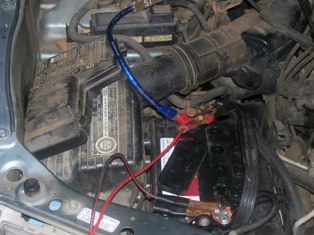

will someone show me there amp power cable connected to their battery i wanna see pics?

i need some pics because the ring terminal on my battery is really skinny so im wondering if i can even hook up an amp to it

my chevy silverado and its a side mount
Username: Nd4spd18
Northwest PA
Post Number: 7629
You need an adapter.
http://www.crutchfield.com/App/Product/Item/Main.aspx?g=713&i=211BAGMT&tp=2681
Username: Slivdogg
St.ignace, Mi
United states
Post Number: 51
Registered: Jun-08
well cant i use a 4 guage ring terminal cuz my power wire is gonna be 4 guage?
Username: Somedonniedude
Illinois
United States
Post Number: 1653
The ring terminal for your amp wire will most likely not fit between the clamp and the battery, usually since where the crimp on the ring is too close to the clamp not allowing the hole to line up witht he bolt, or the ring is too thick for the bolt to really grab the threads in the battery since the factory bolt is too short. It will be much easier and look cleaner with a new bolt like M.S. posted. You can pick one up at autozone for around $5.

You need the adapter to get the ring terminal on the battery.
