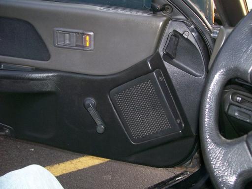

[IMG]http://i300.photobucket.com/albums/nn4/th3pwn3r/Pod%20Build/DriversDoor.jpg[/IMG]
Here we have the driver's side door and once closed we pretty much have no room for any decent setup here.

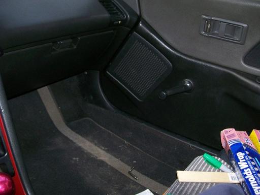

[IMG]http://i300.photobucket.com/albums/nn4/th3pwn3r/Pod%20Build/PassengerDoor.jpg[/IMG]
Passenger side kick.

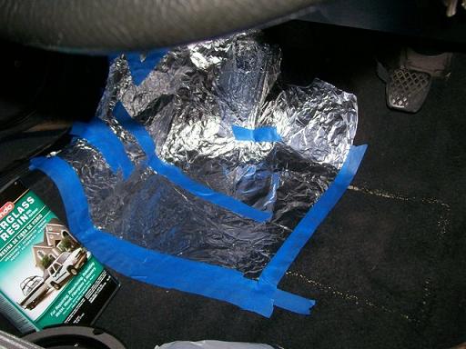

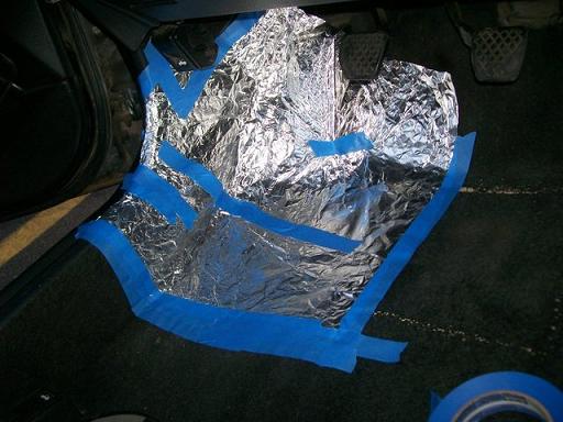

[IMG]http://i300.photobucket.com/albums/nn4/th3pwn3r/Pod%20Build/DriverMask1.jpg[/IMG]
This is the first step to making custom kick pods after you have the vision in your mind. You have to mask off the area where you're going to create mold. I recommend that you mask off a large area so you don't get resin all over your carpet and ruin your interior. I used foil and tape to prevent any leak-through.

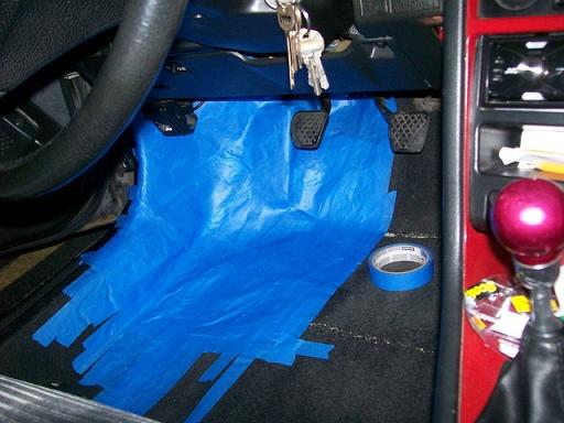

[IMG]http://i300.photobucket.com/albums/nn4/th3pwn3r/Pod%20Build/PassengerMask1.jpg[/IMG]
Passenger side masked off.

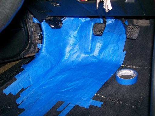

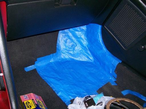

[IMG]http://i300.photobucket.com/albums/nn4/th3pwn3r/Pod%20Build/DriverMask3.jpg[/IMG]
Driver's side fully masked. Note the clutch pedal clearance, not much.

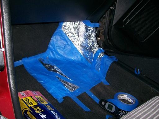

[IMG]http://i300.photobucket.com/albums/nn4/th3pwn3r/Pod%20Build/PassengerMask2.jpg[/IMG]

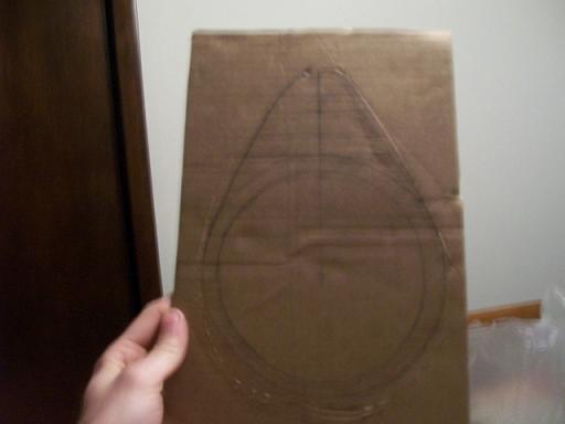

Passenger side fully masked. After finishing the masking you have to draw out the shape of your pods as best as possible.

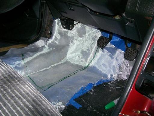

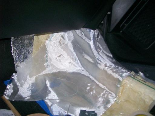

[IMG]http://i300.photobucket.com/albums/nn4/th3pwn3r/Pod%20Build/DriverMatLaidout.jpg[/IMG]
Here you can see where I laid out my fiberglass cloth and traced through my old shape drawn on the masking.
[IMG]http://i300.photobucket.com/albums/nn4/th3pwn3r/Pod%20Build/PassengerMatLaidout. jpg[/IMG]
Here's the passenger side mat marked off, I'll have to say that I'm not a fan of mat and that I'll use cloth every time from now on.

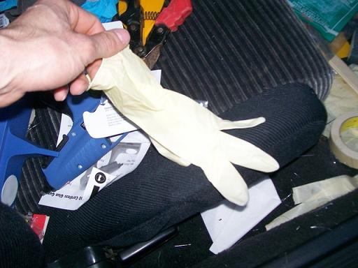

[IMG]http://i300.photobucket.com/albums/nn4/th3pwn3r/Pod%20Build/Latex.jpg[/IMG]
Very important to have these latex gloves, I recommend buying them in bulk. They'll protect your skin and your hands won't be impossible to clean.

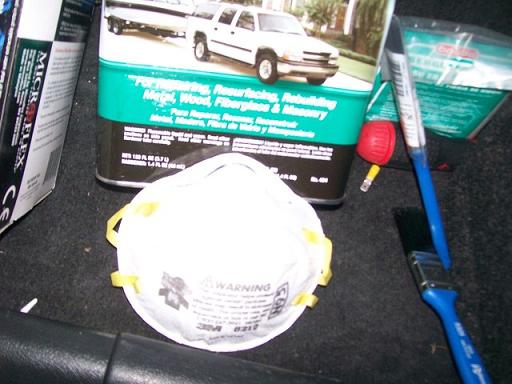

[IMG]http://i300.photobucket.com/albums/nn4/th3pwn3r/Pod%20Build/FaceMask.jpg[/IMG]
Another very important tool in using resin/fiberglass always use one of these masks, the fumes can burn your face just so you know.

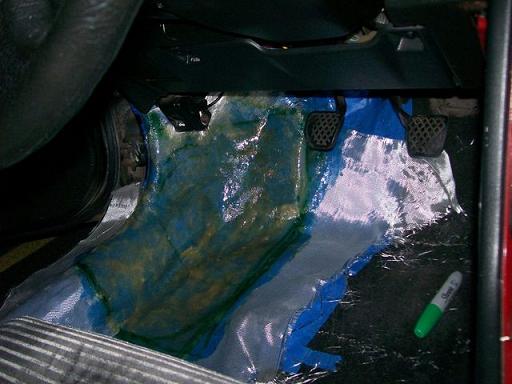

[IMG]http://i300.photobucket.com/albums/nn4/th3pwn3r/Pod%20Build/DriverResined.jpg[/IMG]
Driver's side resined. For some reason my first layer of mat came apart on me on this side and it didn't happen on the passenger side but oh well, I fixed it with another couple of layers on top to provide strength to the mold. I recommend always doing any type of fiberglass pod with at least 2-3 layers of mat or cloth!!!

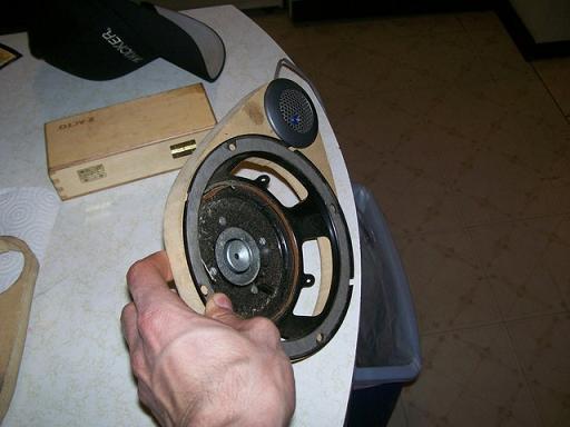

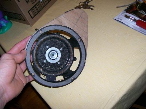

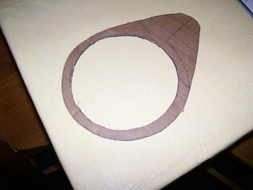

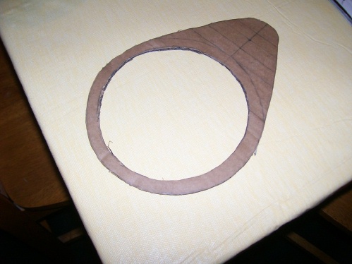

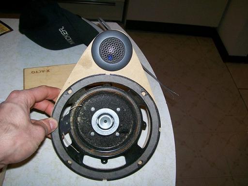

[IMG]http://i300.photobucket.com/albums/nn4/th3pwn3r/Pod%20Build/MDFTemplate3.jpg[/IMG]
What we have here is our speaker mount template. This will be the start of our pod frame. A compass will come in handy or an old speaker laying around to trace with. I free-handed these mostly and this step isn't required as you can just go straight to the MDF with your shape or design but this is my way of making things look a bit more uniform, I guess.
[IMG]http://i300.photobucket.com/albums/nn4/th3pwn3r/Pod%20Build/MDFTemplateCut.jpg[/IMG]
I used an exacto knife with a fresh blade to cut it decently and then fine tuned it. It's better to cut large and then shave or or fine trim the edges in this case.

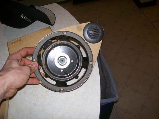

[IMG]http://i300.photobucket.com/albums/nn4/th3pwn3r/Pod%20Build/MDFTest.jpg[/IMG]
Test fitting into the template, looks good!

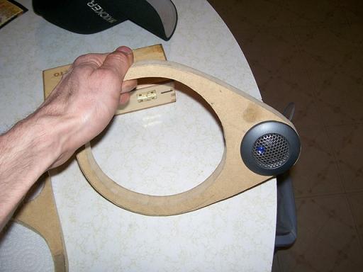

[IMG]http://i300.photobucket.com/albums/nn4/th3pwn3r/Pod%20Build/MDFTest2.jpg[/IMG]
Then I took the template and traced it onto MDF and the above was the end result.
[IMG]http://i300.photobucket.com/albums/nn4/th3pwn3r/Pod%20Build/MDFTest5.jpg[/IMG]
Test fitting, fits great. You may want to make your mount a bit larger as this doesn't allow much room for your pod frame.
Here we have our driver's side kick which will have to be where we place our pods.
Passenger side masked.
I think this forum messed this all up...

how much room is there for the clutch? thought about doing pods in my rex but im tempted to just redo the top of the dash and mount everything there :-)

Kevin, there's enough room to drive comfortably. You also asked about the wrap and it actually looks good but there are a couple of types out there and to me the one I chose looked the best. Not easy to work with on contoured things that's for sure.
