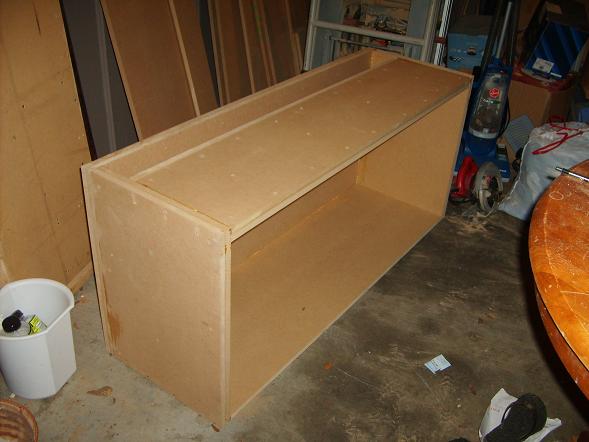

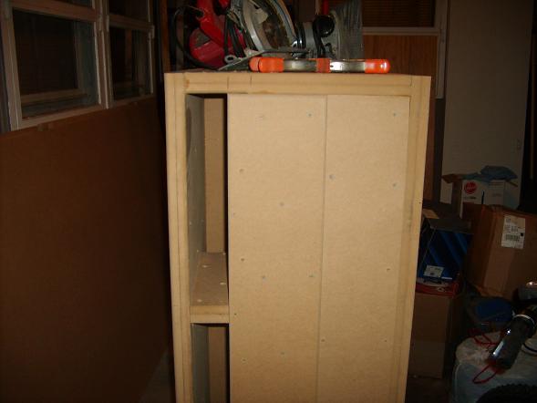

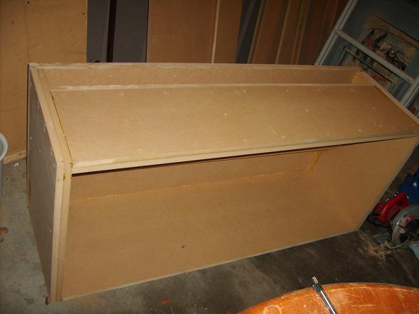

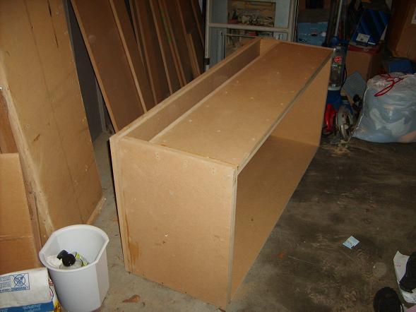

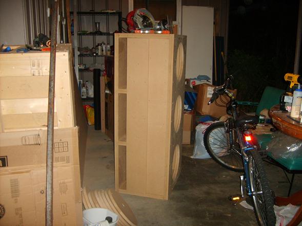

Well, I started on the 3 DD3515 box today.
EVERYTHING is going to be doubled...the baffle will be tripled.
165sq inches of port and the port will have 2 dividers in it to allow me to block 1/3 of it for daily driving :-)
So...on to the pix:

Yea, I'm going to try subs forward, port up. It works in mini-trucks, but to tell you the true I have never seen a loud full-size truck w/ this design.
Well, really I don't see many loud full size trucks at all...unless they are all out walled.
I have no idea if this box will do well or not, but I wanted to try it. I thought about subs up, port up on driver's side...but thought that may lead to some loading issues w/ 3 subs.
The port will actually kinda like my interchangeable slot-vent design but w/ no T-nuts. It will not be as easy to remove and change, but will be swappable. I can easily change the port width from 3.25" to 4" (or anything between). With alil more work, the port length can be changed also.
This first port should peak at 46-48hz if I looked at it right. I can always open up the port and get the note up alil though. The box is only going to be ~9.5cuft net.

My truck like's ~48-51hz depending on how much space I take up in the cab w/ the box. This box is going to give me ~3.15cuft per sub. I know mini-trucks go w/ 2-2.5cuft per 15", but they peak in the 58-68hz range.
I got the box mostly done today...only 2 baffles though for now. I will add the 3rd tomorrow and do some sanding. Going to do some caulking later, gotta get some food right now.
I'm going to get everything mounted tomorrow after work. May even get some #'s unless my neighbors b7tch.
Moar pics coming soon.

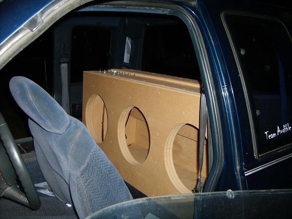

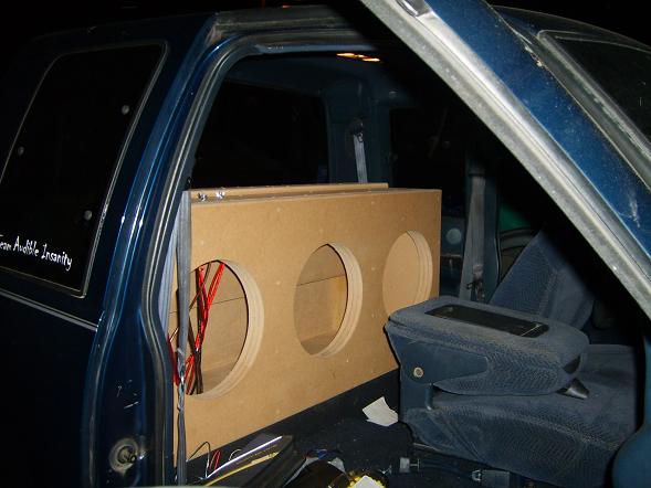

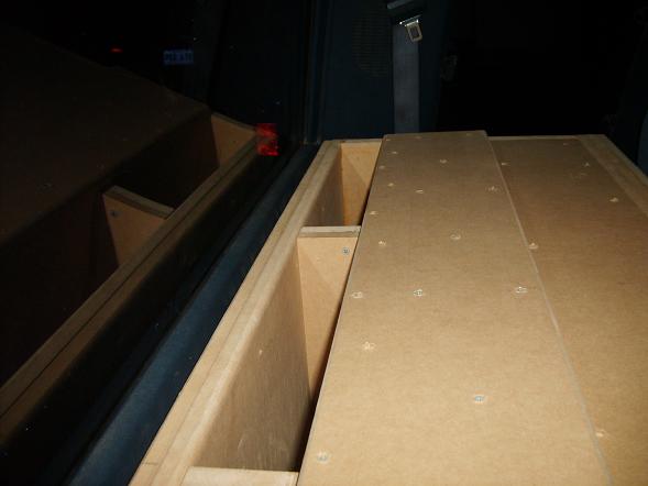

I jumped on it this evening and got alot more done. Got the third baffle layer on and got alot of sanding/routering done.
Ran into alil hang up though.
I pulled the seats and old box out of my truck, only to find that I had no one at home to help me get this heavy SOB in the truck!!!
So, I fought w/ this dam thing to get it in the cab. Its a hell was of a tight squeeze and its fvking heavy!!! But I got the dam thing in the truck.
So...moar pics:

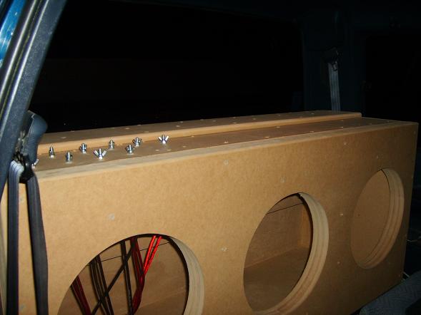

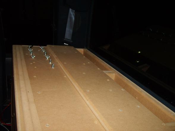

When I say everything is doubled...I mean EVERYTHING. Even the port and port braces.
Username: Southernrebel
Monroe, Louisiana
2 DD3515s, 2...
Post Number: 6416
Registered: Mar-04

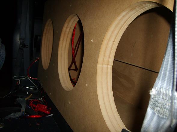

Ran out of bolts for terminals, gotta get some more tomorrow.
It WILL play tomorrow after work...I just took me so long fighting it to get in the truck that I ran out of light.
