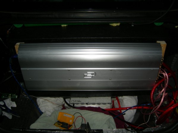

DD Z1a with a BatCap 8400 (16V) underneith, also backed by two 2200 dual voltage batteries (12/16V) so to give you an idea and this is a daily... Polo..

clean that sh!t up polo...looks like my toilet after hotwings. haha
jk
Username: Kingandsons07
Lincoln, NE TEAM RD
U.S.A
Post Number: 974
sexy amp =]
