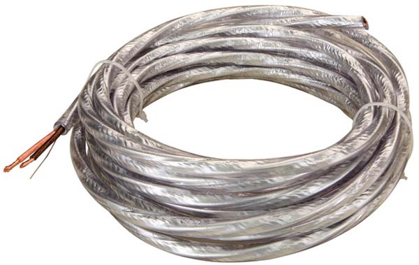

install is key, dynamat and nice wire.. don't skip the little things

well i got all the sound deading covered already about 80 square foot per door, the far inside sheet metal, then inner part(where all the holes are on the door) and then the actual door panel all has plenty of deadner, the wires? what do you mean, and as far as the HU im uhh still working on that lol, im big big biggg into SPL and doing pretty good, but then for MECA i started competing for the best of best of show so now i gotta work on my SQ crap
