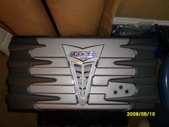

i have a kicker kx450.2 for sale it would be perfect for them does 500 rms @ 4 ohms bridged. will sell for $200 shipped wit a tracking number
Username: Dirtrider125
Post Number: 129
Registered: Apr-07
