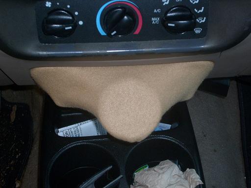

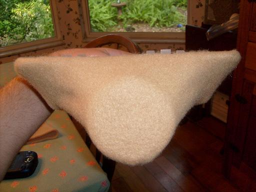

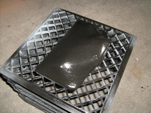

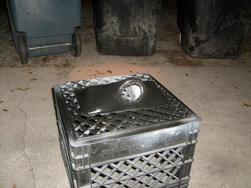

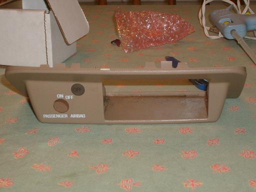

My first time at this im trying to glass in a stinger volt meter i bought ive got the piece all wrapped up in fleece and hopefully ill get to glassing tomorrow any advice would be great.

looks like you may need to stretch that fleece a bit more
should look good tho, only thing i'd do is slightly turn it your way.. maybe cut your piece your working with to recess it in more

did you sand the edges of the plastic piece? make some deep scratches so that the resin will have something to grab onto.

thats a good idea i might turn it but ill have to see how much work that will be lol
thnx for the advice berny i didnt do that but i will

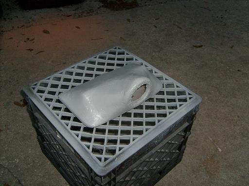

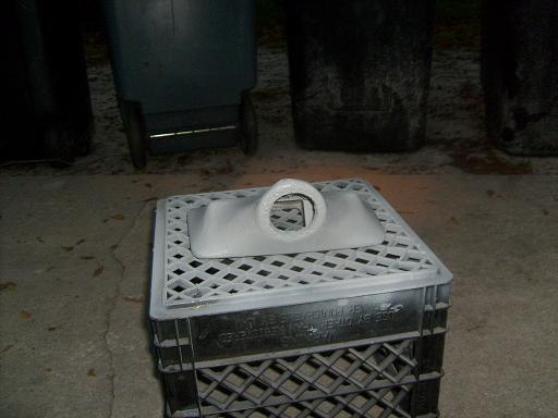

glassed primed and painted i didnt sand it alot i thought the bedliner would fill better but oh well thats how it goes some days.

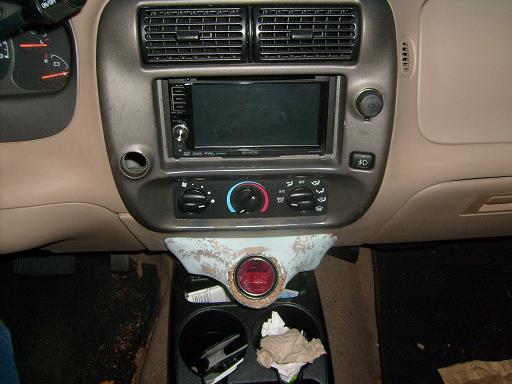

did some more coats after this pic so it looks a lil better hopefully ill install it tomorrow

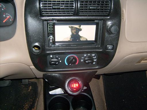

thanks hopefully ill have her wired up tomorrow nite

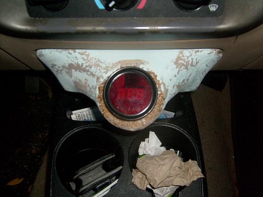

whats is supposed to be???

voltage meter

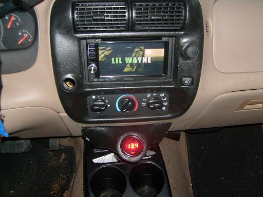

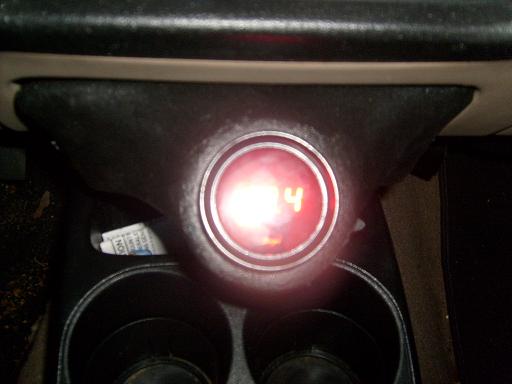

did a little more sanding on the face and got her all dialed in not perfect but im happy for my first go at it.

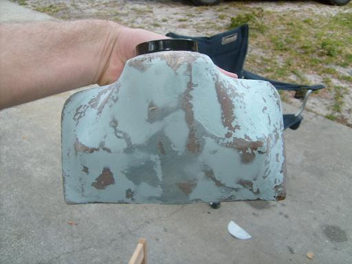

nice job. Glassing can be very fun.
btw, what the heck is the first pic about? Is that where the pod lives? instead of that?
Username: Surferdude9371
Im BTL Bumpin
Post Number: 917
that plastic piece was my base for the project i wrapped it in fleece
