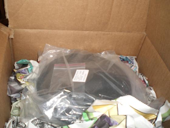

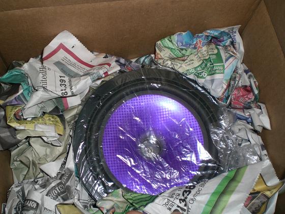

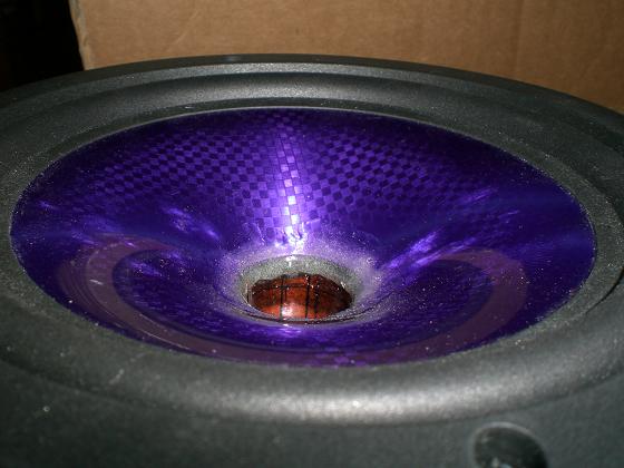

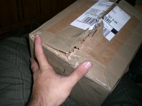

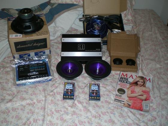

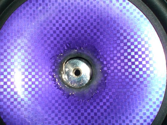

I thought I would post some pics of Chad's amazing repair job, as well as everything that's going into my blazer soon.
chad's consistent and amazing overpacking job, notice the newspaper....:-)

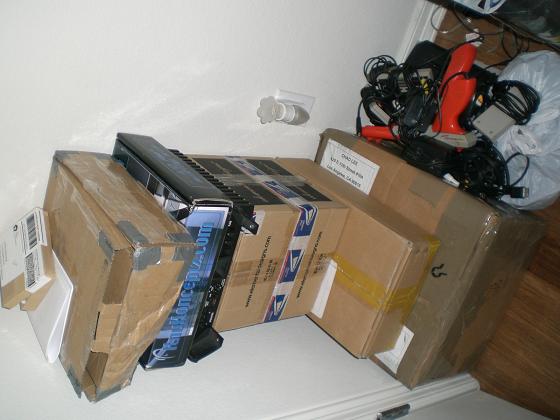

he did an even better job with the replacement speaker for the above one, since the above speaker was blown :-(
stack of boxes I have accumulated, as well as my $30 worth of original nintendo, 2 guns, 3 controllers, all the marios, and many other games, also a Sega genisis console...lol
I'd like to thank Chad for the RD55.4, alpha comps, including the replacement speaker, a ton of other stuff I didn't really need but he sent anyway. I'd also like to thank Steve for the EQ, I will hopefully have everything done tomorrow:-)

lol did chad send the korean newspaper cause thats what i got from him lol
Username: Jtown
Team RD, Texas
Post Number: 2854
yes! it took it out and was like, wait...

my repair job isn't the best but it works.

Good job, Chad. No offense, but those are possibly the ugliest comps I have ever seen, haha. Glad they sound nice though.
Username: Jtown
Team RD, Texas
Post Number: 2857
eh, I like the purple look even though they will prob be covered and hidden from sight. I may be adding some blue neons for accent lighting in the cargo area and maybe under the seats, so it would go well.

Damn Chad you get down with the packaging. I expect the same package with my speakers.
Diamond Member
Post Number: 20773
ima deliver yours in person man. lol.

A pic is worth
1000 posts!!
Post Number: 16519
I'm diggin' the Maxim mag.
Username: Snarl2004
Digital Design 9515, Massive Audi...
Post Number: 2369
ive got that issue of maxim haha
Username: Jtown
Team RD, Texas
Post Number: 2860
yeah that's a special shout out to Chad lol.

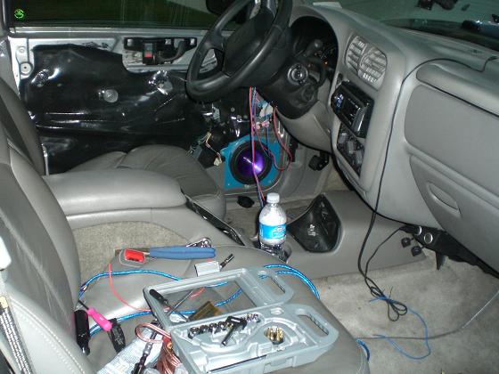

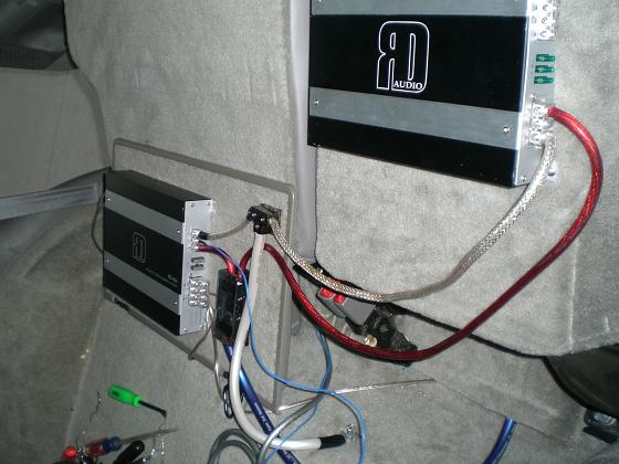

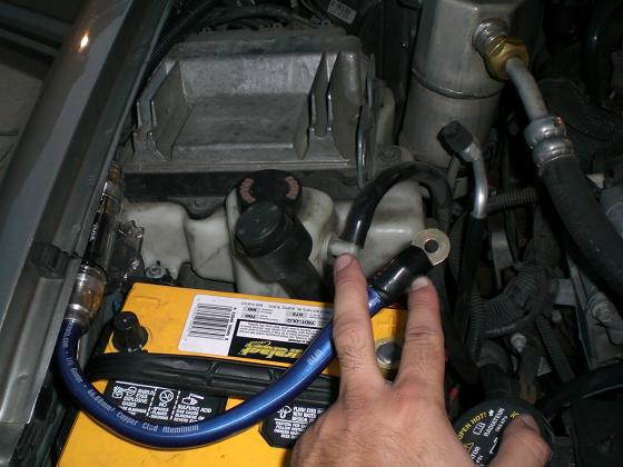

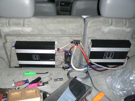

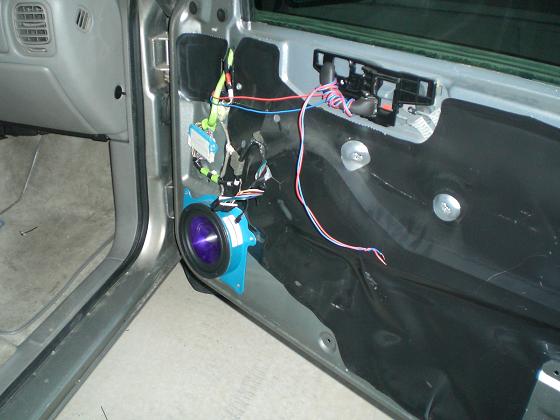

I have the power wire completely done besides shortening it for the distro, newly drilled hole in the body sealed.
Mids are in and wired to the xovers. Thanks for the random weather stripping Chad.
Ground wire is ready to be mounted and installed (including its own disto).
Tomorrow:
Find a spot for the tweets :-(
Wire the Tweets
Run wire to the amps
Run interconnectors to the front(don't know if I'm gonna install the EQ just yet, no mounting brackets)
Put the blazer back together
I'd just like to say
F
U
C
K
General Motors and their 3000 screws per vehicle, as well as their seemingly useless metal and plastic brackets throughout the vehicle, especially behind the dash.....grrrrrrrrrr
Thank goodness for my girl, she came over and cooled my nerves, also helped by installing the passenger side mid. saved me a lot of time. All these d@mn screws, as well as the labyrinth I have to navigate the wires through, are really holding me back...

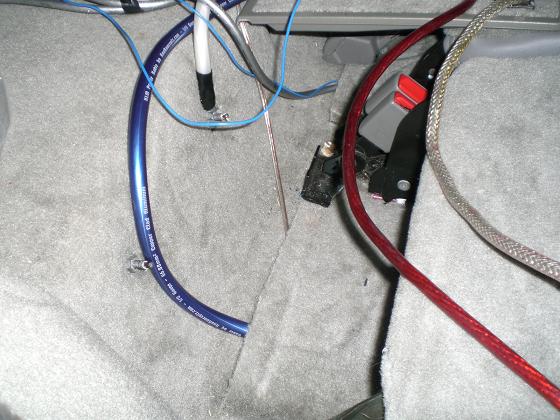

Username: Jtown
Team RD, Texas
Post Number: 2868
here you go chad.
looks kinda tacky, don't really care it was left over wire, and I'll prob be re-locating the distros.
passenger door
driver door w/ my trusty snake-driver :-) :-)
xovers where the stock tweeters were
0ga is a b1tch to run.

x2 on the 1/0klm (when its real hot out though it seems very flexible)
You've been busy tonight thats for sure. Looking good. Just clean up those wires now.

yeah they are a bit everywhere lol. chevys are a b1tch to run wiring through, that's for sure.
