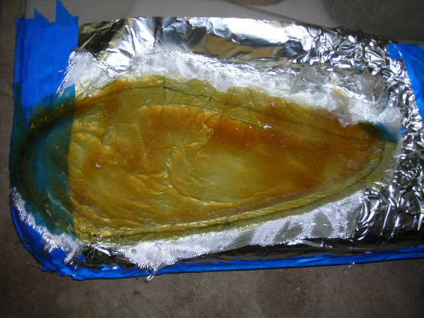

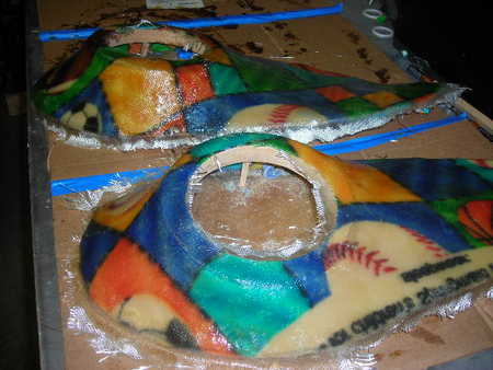

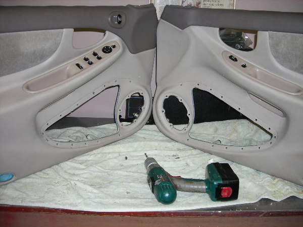

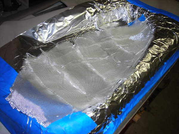

Well guys, here is my first attempt at fiberglassing. I figured I would start with a good beginner project, so here it is.
Speakers: FREE Boston Z6s
Amp: Kicker 350.4 (I don't know if I am going to go passive or active yet)
Day one:
Took off the door panels.
The map pockets had to go :-)

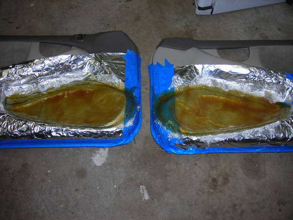

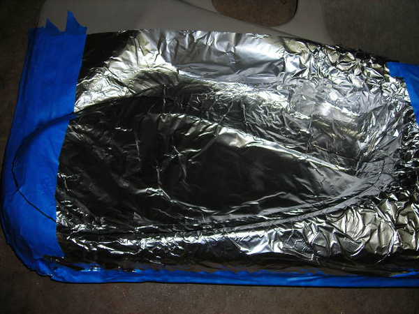

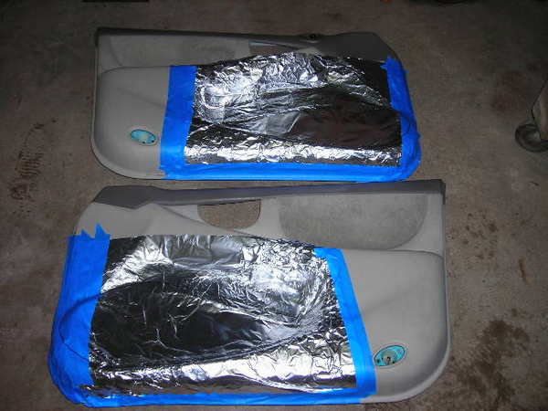

Got my mold laid out with tin foil and a perm marker
Got the matt cut and laid out to see how it will go.

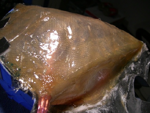

Well here is the mold. Has 3 layers of matt on each. I used the whole quart of resin lol.
That's it for day one :D
Tomorrow morning I will make a wal-mart run and buy some dowels, more resin, and some fleece to make the top part of the pods :-) This is my first so don't go too hard on me :p
Username: Philly306
James Carrol is the re...
Post Number: 1083
Registered: Apr-07
looks good, ive never seen the tin foil idea before usually just covered with tape
what type of mat tape did you use?
Username: Denali_on_22s
I get Bucks like Milwa...
Post Number: 5648
looking good man. keep it up.
Username: Tatonka
-[Team Audib...
Post Number: 1647
"what type of mat tape did you use?"
Resin and matt is Bondo :-)
"looking good man. keep it up."
Thanks Reece :-)

on ff forums the guys don't think too highly of bondo but i hope it works out for you.

bondo brand ftl, but looks good.

"on ff forums the guys don't think too highly of bondo but i hope it works out for you."
Yeah I know, but it is just my first project.
"bondo brand ftl, but looks good."
Knew the bondo comments were coming lol. Thanks berny and Phil :-)

How many layers of mat did you lay?
Username: Tatonka
-[Team Audib...
Post Number: 1649
I laid 3 canaan. I used all the matt, so like on 1/3 of the passenger pod there is only 2 layers :-(

Looks good. Ease up on the resin. Looks like its puddleing. Should just use enought resin to wet the mat, one layer at a time. But looks good.
Username: Tatonka
-[Team Audib...
Post Number: 1650
Yeah Marc, I learned to use alot less lol. I think I am getting the hang of it. I'm about to go mount the speaker rings. More pics in a few hours guys.

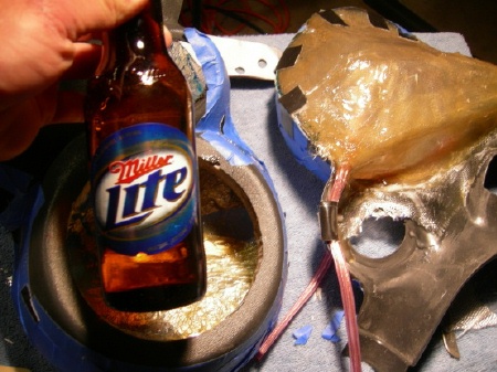

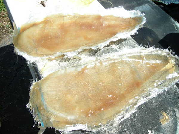

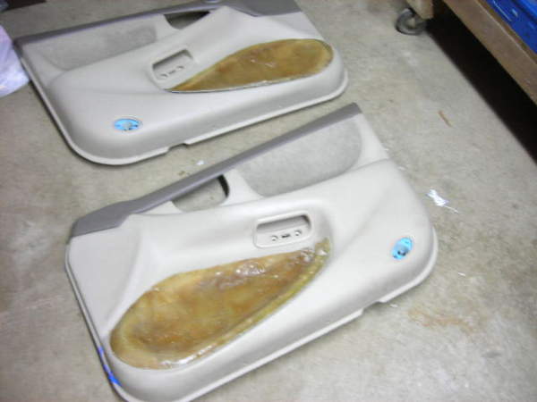

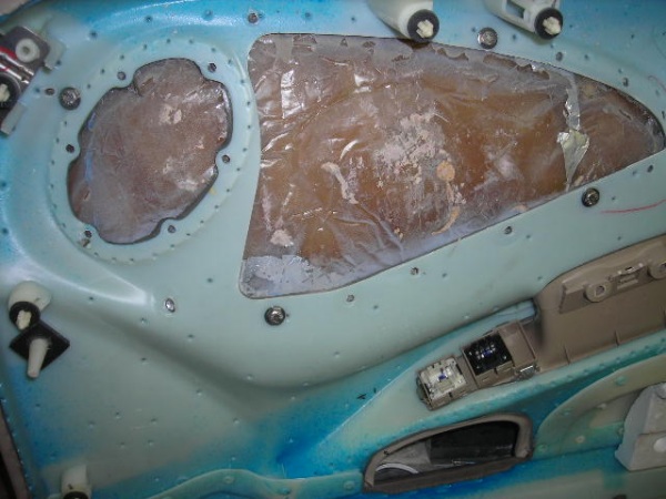

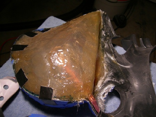

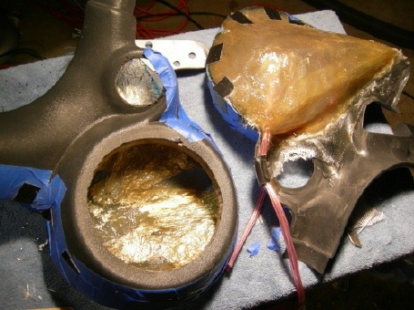

Day 2:
Well guys, got a little bit done today, but tonight I ran into a few problems concerning speaker placement. I'm going to have to spend a full day just trial and erroring how exactly to mount the speakers. I went thought a pack of dowel rods tonight with no luck. I'm also going to have to trim the molds some more in order for the pods to not get in the way of the dash. *sigh* The Alero is just too crowded.

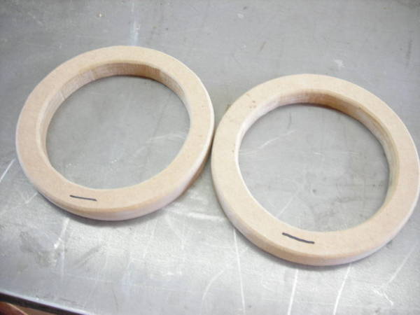

Molds out the door
Speaker rings FTW
Molds trimmed up
That's all the pics for today, I will try to work some more on it tomorrow :-)

very nice nick, your now a pro.

Post Number: 481
Registered: Apr-07
saran wrap and clear tape is all you need!! I've never seen tin foil used! did it stick?? let me know! thx
Username: Nyyfan13
15 MAG
Post Number: 9500
Looking good Nick. Nice bud
Username: Safe_cracker
Chicago, IL
US
Post Number: 4456
I have always used foil, works best if you use shiny side up. Honestly to me it works better than anything it tends to stay in place and conform nicely. Polo.
Username: Frkkevin
¤ Resonant Engineering..., ¤ Fort Worth...
Email
Post Number: 5013
^^ yep.. and if it does stick for some reason it tears easy and you can just leave it on the back of the pod :P
Username: Tatonka
-[Team Audib...
Post Number: 1652
The tin foil works great. It stayed in place and took the absolute shape of the door. It also doesn't seem to mind how hot I mix the resin :D
Im about to go put these 15s in a dodge truck today, so I might not get too much done today :

^^^^ Mix it to hot and it will stay tacky, been there done that!!! Had to remove the old sh!t and start over on an old box I did. I now mix it in 3oz cups with exactly 14d drops/oz of resin, works perfect and I get plenty highhhh. BTW will be pouring more tonight. Polo. :-O

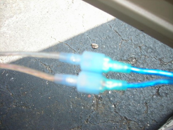

Haven't been able to work on it for a few days because I've been working on something else. Today I couldn't get much done due to burning my hand.

Setting 24gauge wire on fire then grabbing it :-)
Username: The_image_dynamic
San Diego, California
Post Number: 3958
Oh damn man Did the plastic burn into your skin?

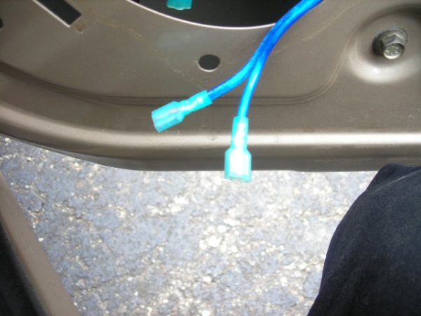

Username: Tatonka
-[Team Audib...
Post Number: 1688
Yeap. Will post some pics later tonight.
Post Number: 3959
At least it wasn't 1/0. That's hospital time.
Username: Nd4spd18
Northwest PA
Post Number: 7521
More importantly HOW did you manage to burn yourself with wire and more importantly than that, WHY did that wire not have a fuse on it.

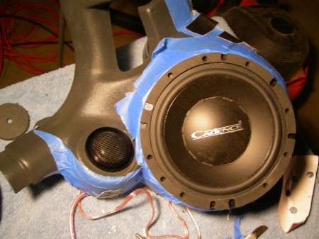

Username: Tatonka
-[Team Audib...
Post Number: 1690

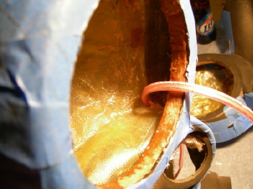

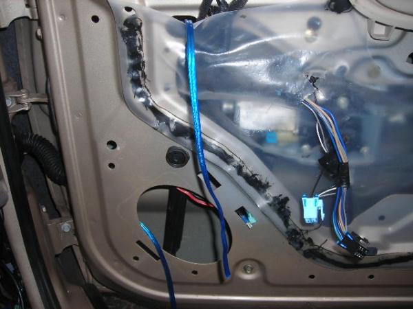

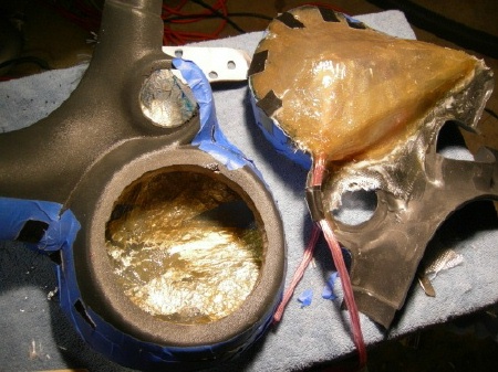

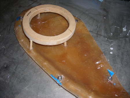

Ok guys, Here are some pics finnally lol.

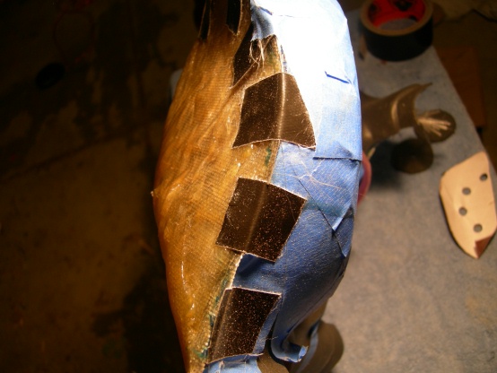

I got my rings mounted like I wanted them.

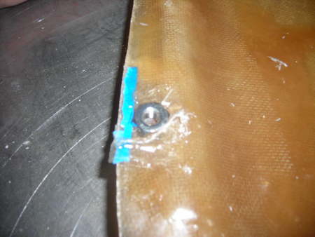

I came up with this idea to resin botls onto the molds and bolt them onto the door through the factory rivet holes :D

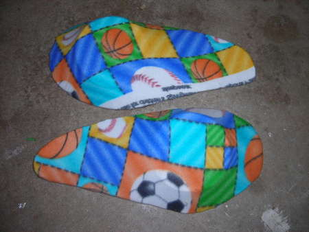

I have my rings wrapped and ready to glass. I messed one once already because I wasn't sure how to approach it, but now I think i have a better idea of what to expect :D
the gf being bored with the camera lol

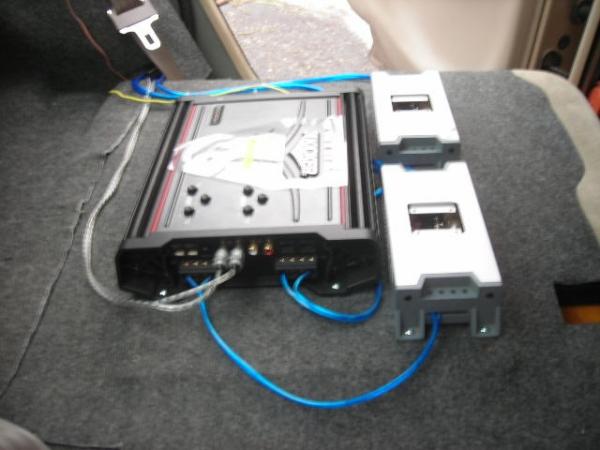

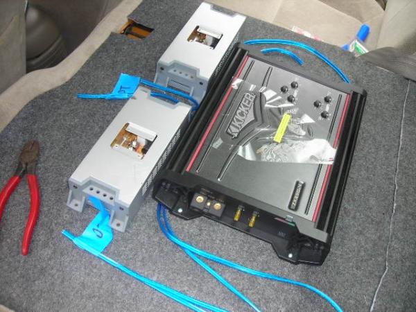

"More importantly HOW did you manage to burn yourself with wire and more importantly than that, WHY did that wire not have a fuse on it."
I am not sure why the wire was burning up. I had my temporary HU hooked up in the back of the car testing out a customer's amp, and the next thing i know, the wire started burning up. So without thinking, I grabbed the burning wires and ripped them from the spades connecting them to the battery. I have used this hu on the same wires a few times and it has never given me any trouble till now. Why didn't I fuse it? Because I created this harness the night before a competition the next morning and I did not have a inline fuse handy. It is only hooked up while I'm sitting there burping. My inline fused I ordered for it a few days ago has not yet arrived. It really is not a big deal though lol. Just a few burn/cuts on my fingers.

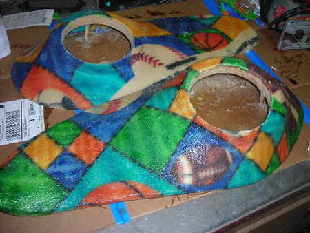

looks good make sure that fleece is tight cute pattern btw
Username: Tatonka
-[Team Audib...
Post Number: 1692
"cute pattern btw"
Awe thanks :D It's the thickest fleece they had at wal-mart.

Looks like its coming along nicely. Good idea with the nuts. Post more pics and keep inspiring me. :-)

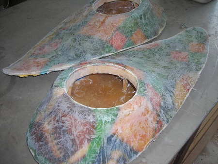

Iight guys. I have done a little bit more work in the last two nights. All I got left to do tomorrow is sand, filler, sand, sand, and some more sanding to get these things ready for paint in the near future.
I resined the fleece to the edges.
Once those cured, I applied a layer of mat for strength. This is where I left off tonight. I will let them dry over night and work with them some more tomorrow.

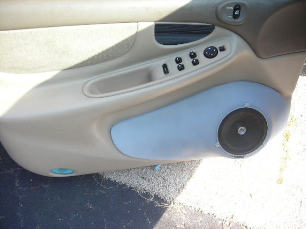

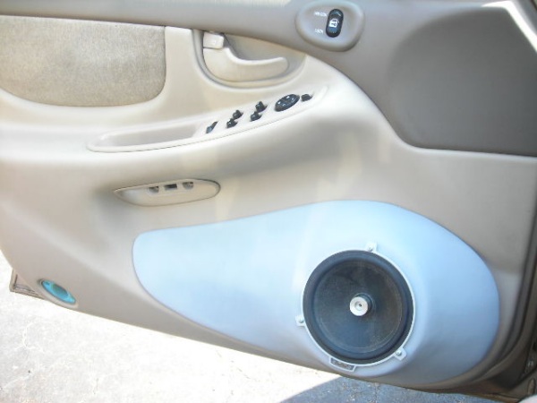

The only thing I see wrong here is the tiny amount of air space your speakers will have. I guess they'll work depending on what you install though.

Anyone else have concerns with the air space or is it just me? We'll see how my project turns out haha.

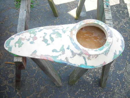

Username: Tatonka
-[Team Audib...
Post Number: 1711

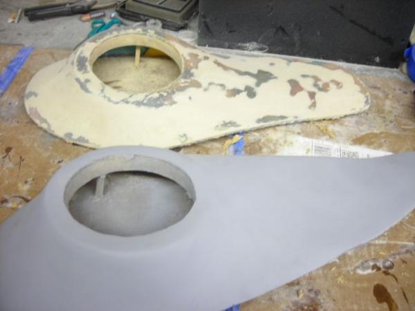

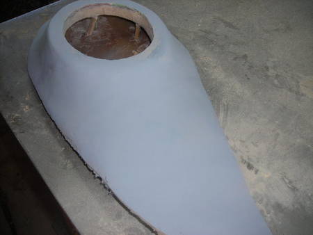

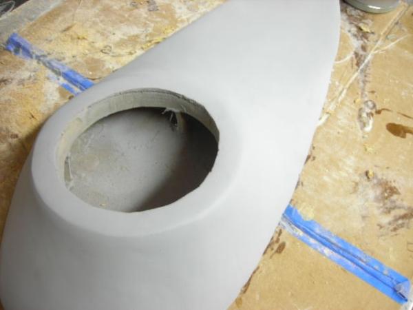

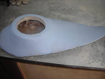

Alright guys, today i got one pod filled and primed. The first attempt was a mild failure since I am learning and trying to figure this out as I go. Here are a few pics
The sisters with their matts nice and trimmed ;)
A pic of the first attempt at filler on the pod
A coat of primer. I do have a few pinholes and a few minor sanding imperfections that I think can easily be fixed, I just have to figure out how to do it.
If anyone has any tips on fixing the pinholes and any tutorials on body filler, it would be greatly appreciated. I want to get this one pod perfect before I start on the next :-)

Username: Frkkevin
Team DLS
SuperNatural...
Post Number: 5152
if its just pinholes, get yourself some fiberglass jelly resin and just dab it on the pin holes and smooth it out.. let it all dry and resand
best thing to do is get flat black spray paint and then sand, youll see your high spots very quick when you start sanding over the paint

Thanks for all the feedback guys.
I just got back from getting some spot putty. I'm going to see how this works tomorrow with filling in my minor pinholes

Ya Rob I thought the same thing but chances are it is just the depth perception of the pic, I know a Cadence CVL would not fit in there. I had to constantly have driver on hand to make sure it would fit at every step. I found when using actual fiberglass instead of fleece It cam eout alot smoother, easier to work with but need more layers which was ok, let me build it up/more flexible. I will have pics of my modified Q-pods after this weekend. Polo..
Username: Tatonka
-[Team Audib...
Post Number: 1714
The driver does fit in perfect (made sure when I was mounting the speaker ring lol)
There is also actually a little bit of room. Even with these pods, I will not have much foot room lol.

Guys I got the other pod filled today, but I just can not seem to get these things in paintable shape :-(
I'm considering just wrapping them.
Username: Big_edge_head
Milwaukee, Wisconsin
Post Number: 2212
Got anymore pics, Nick?
Username: Frkkevin
Team DLS
SuperNatural...
Post Number: 5160
takes a lot of work to get pods ready for paint.. have you tried using filler primer?
Username: Surferdude9371
Im BTL Bumpin
Post Number: 980
ya use a high build primer you used body filler right?
Username: Tatonka
-[Team Audib...
Post Number: 1723
yeah, i used body filler and filler primer. There are just a few high spots and craters left in the filler that I can not seem to work out. The pinholes are no problem, its everthing else that I'm trying to get fixed lol.

Well guys, I got quite a bit done today. Hopefully I will finish it up tomorrow.
I decided to wrap the pods because there was a few bad edges where the fleece and glass meet that were not fixable. But just to see if I could do it, I tried getting one paintable with no imperfections and I did it :D
See any bad places lol?
I will finish up the other one tomorrow and wrap them both

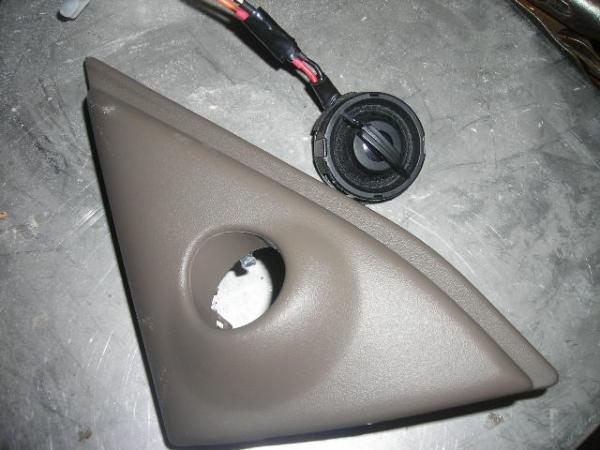

I really want to put my tweeter in the factory location, but im going to have to turn this piece into a tweeter pod ;) That will come soon.

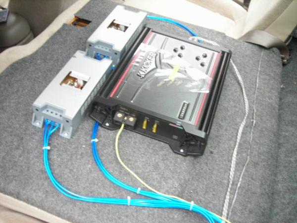

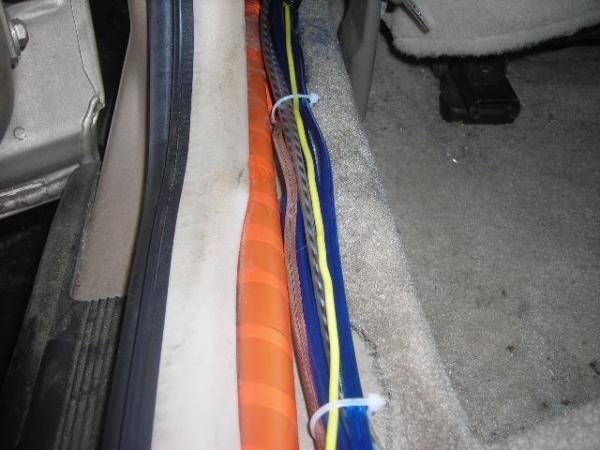

Just laying out the wires
Here are a few pics of the final product without the power and ground ran. My goal was to make it look as clean as possible.
Just to show that the rest of the install is clean also. There were no shortcuts taken lol.
A gallon of Red Diamond Tea and hours of sunburn later, I finnally finished it up. Here are the wires in place ready for the pods and tweeters

I love the smell of resin, hardner and wash it down with some Miller Lite lOl! :-O Polo..
Last pic is me coaxing the cure with infrared lamps...

looks like your getting there. btw, theres a stuff called spot filler, comes in a tooth paste type tube, usually red. I use that to fill in any pin holes and scrathes. put 1-2 skim coats on, wet sand with like 600 grit, prime paint.
You can see the red areas in this.
Painted.

Yeah Marc, I used that stuff for minor pin holes. Worked great :-)

-[Team Audib...
Post Number: 1765

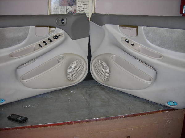

Well guys here are the promised pics lol.
Heres a pic of the wires coming out of the door. To connect the wire running out the back of the pod to the wire running from the door, I decided to use spades since I'm always taking my door panels off.
Then I bolted the pod to the door panel. This idea worked perfectly.
Here is the spades connected to each other running to the pod.
And here is how they looked on the doors :-)
I really could not have done this project without the help of Berny Mac and Canaan. Mad thanks to you guys :-)

Username: Frkkevin
Team DLS
SuperNatural...
Post Number: 5188
looks really good.. flows very well with the door..
color match it with the top of the door and youll have secks :-)
