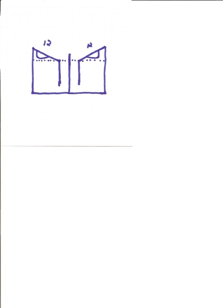

Does anyone like this design? I was thinking of making it, I haven't bothered deciding on tuning and cubes but just wanted too see if anyone thought it was a good idea?Upload

sorry for the wasted space I have never been the best at using picture uploads

Hey come on guys not a single comment on my idea. At least tell me that it sucks.

what will that be tuned too... no one is commenting cause they prolly dont know wtf it is lol need more pics like of side and other views i can kinda make it out a lil

Doing those angled cuts would be difficult since it seems like they are around 30 degrees? Or are they supposed to be 45 degree cuts?

looks like a angry transformer ...
i can follow what u trying to do but that extended separator in the middle is not really serving much purpose portwise but can act as a addded support\brace i guess ....

it could work...just make sure there is enough clearance behind the port and brace the box

Yes I know it is a very crude drawing. I haven't even thought about dimensions yet just wanted to know what people basically thought about placing subs in an angled box like that. After looking at it myself I believe that the top panel would cover the entire structure, rather than stop at the ports. I would like to tune it to 33 hz if I did build it. I would probably stick to the recommended 2.3 from the manufacturer of the speakers. Has anybody ever heard a box with similar design?

very similar to a clam shell design. Now thats thinking "Outside the box"
