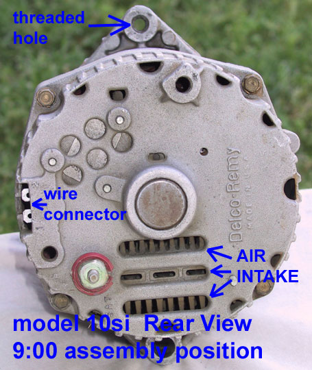

quote:
A point about the “AIR INTAKE,” which is seen in photos of the alternators viewed from the rear, above. Clearly the author has written “air intake,” and not air exit or air exhaust. The fan at the front of these alternators is an exhaust fan. The fan draws air in through the opening at the back of the alternator, where the air will pass through cooling fins at the rectifier heat sink. And the air will be drawn through the stationary “stator windings,” where the air will also have a cooling effect. As usual with moving air through passages, the same fan efficiency will suck more air than the fan could blow through. That’s why the fan at the front is an exhaust fan.

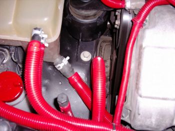

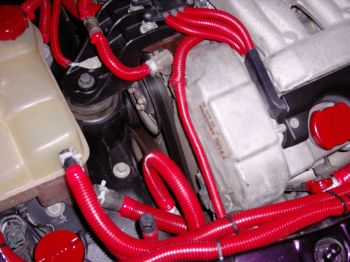

Username: Basebalz13
Moneta, Va
Usa
Post Number: 460
Registered: Aug-07
thats the spot where i want to mount it, the stock spot is on the bottom of the engine, and a complete pain in the azz to take on and off every month
