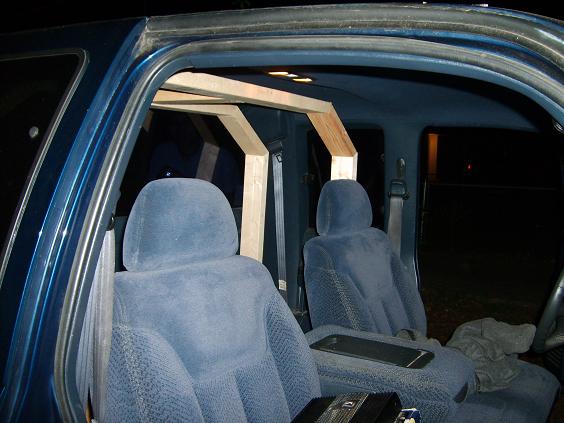

I'm for real, I started cutting some of the skeleton and quickly realized my original measurements where wrong :-(
The angle's just were not working out, but I have it right now. It's 10:15pm now, so no more cutting tonite though.
I'll get it framed up tomorrow and hope to have it up and running by Sunday.

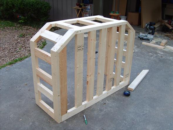

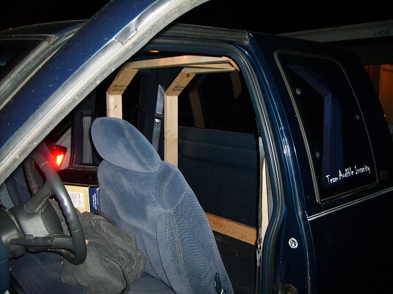

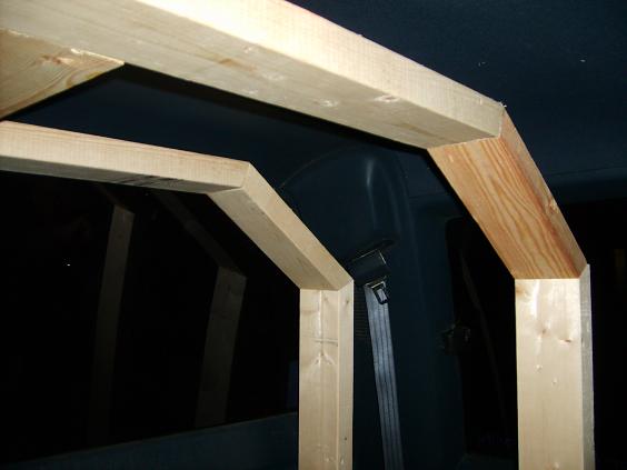

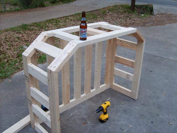

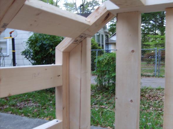

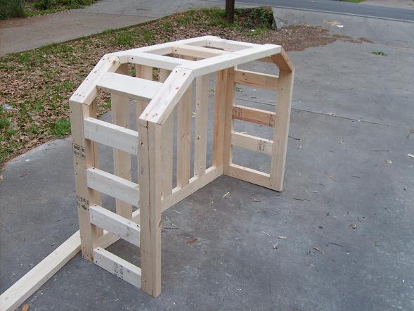

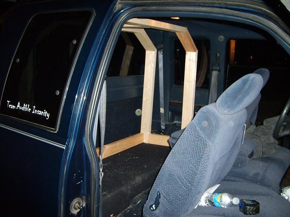

Got alil done on the wall.
Just the very basic layout on the skeleton. The front and back arches are not connected to one another, just layed up in place w/ spacers to get a feel for the size.
I have to recalculate the actual airspace too. Angles had to be totally changed from the original design. This should be PLENTY of space for 2 15's though :-)
I tried to do more, but the mosquitoes were eating my a22 up!
More to come tomorrow.
As is sites, the headrests will be ~1.5" from the baffle

that is insane canaan.

I just crunched some #'s on the new angles and came up w/ ~17cuft gross. So, I'm gonna look at my checking account tomorrow and may go ahead and get the 3rd 3515. Not sure on that one yet though. Prolly just going to try 2 15's to w/ a first try baffle.
I hope to have the wall boxed in by Sunday or so. The baffle will come next week some time.
May box in all but the baffle and drop a DD512 in a prebuilt box in the corner and meter it for the hell of it :-)

Curious, there seems to be a lot of space between the box outside dimension and the interior, what do you plan on using to seal it off? Polo..
Username: Southernrebel
Monroe, Louisiana
2 DD3515s, 2...
Post Number: 6290
Registered: Mar-04
Yes, there is some space on the sides and top.
This will be a semi-removable wall. It will fit through the doors (w/ some help).
I am building a panel to block off the back of the cab from the front though.

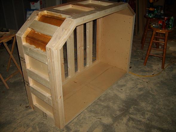

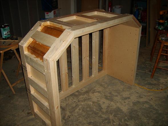

Got the skeleton finished.

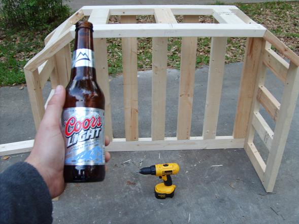

SPL fuel.

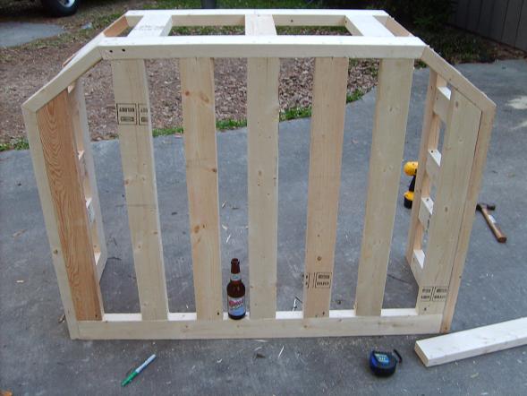

I have a few 2x4's left, so I'm going to brace it some more tomorrow. Should be pulling the seats and putting it in place Wednesday.

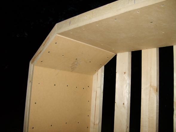

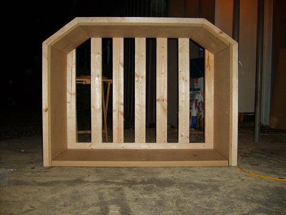

Anyways I got alil more done today.
Its actually starting to look like a box now!
Got the sides and top boxed-in.

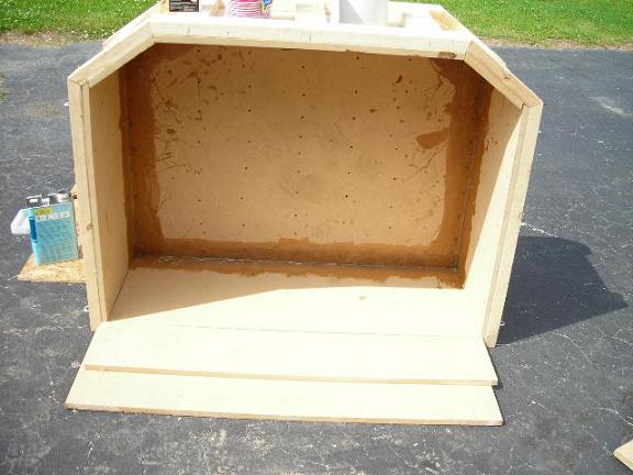

Also started on alil glass on the seams outside.
Here it is w/ the bottom just laid in for a test fit.
Shot of the front.
Just to show how big it is.
Hope its loud

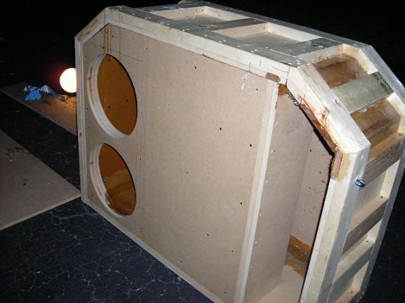

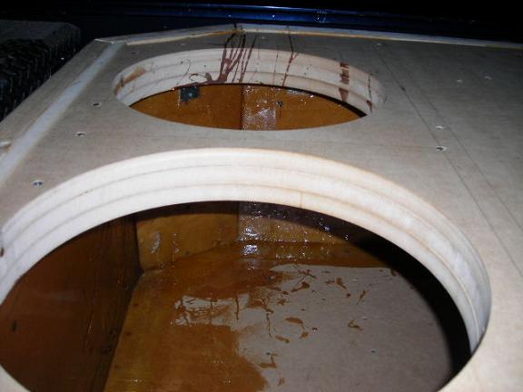

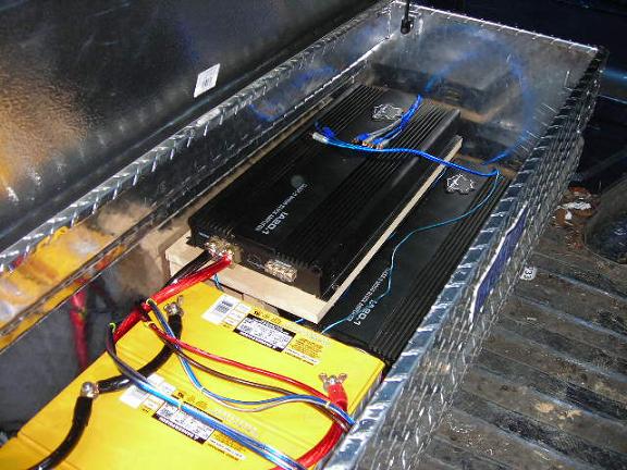

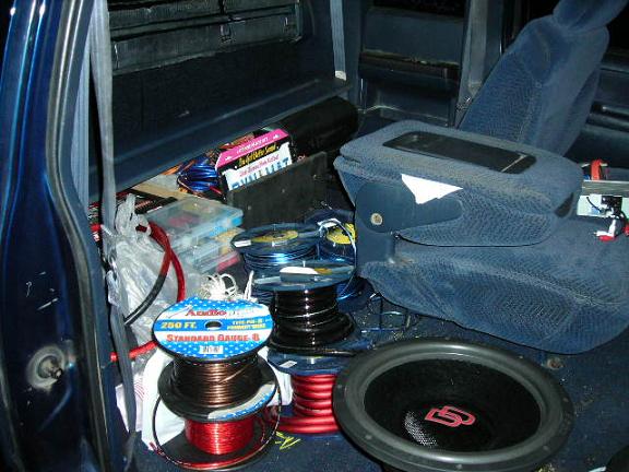

Well, took everything over th NickV's sunday got alot more done.
-Ran 4 new runs of 1/0ga.
-Cut out a hole in the bed/toolbox for -RCA's, power, remote, and speaker wire.
-Built an amp rack.
-Got the batts in.
-Got the baffle on.
-Alil more resin and mat.
-ALOT of sawdust.
Picherz:

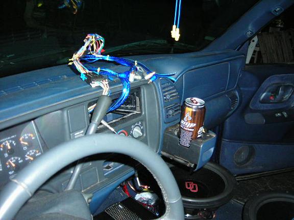

Monroe, Louisiana
2 DD3515s, 2...
Post Number: 6314
Registered: Mar-04
I have been driving around like this for 3 days :-(
At least I had enough wire on hand :-)
All those pics where from sunday.
I layed more glass today and changed the amp rack so the amps face the opposite way.

thats a whole lot of wire. lol.

jesus, is all that dark sh!t in the box glue? I hope I wasn't supposed to use that much, lol
Username: Safe_cracker
Chicago, IL
US
Post Number: 4396
LMFAO ^^^^, It's resin fool. :-O Polo.

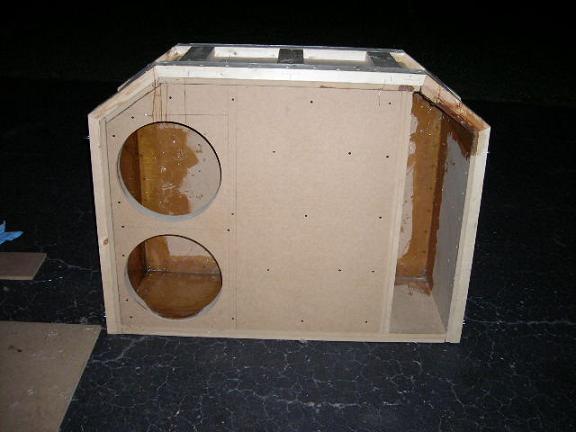

Monroe, Louisiana
2 DD3515s, 2...
Post Number: 6317
Registered: Mar-04
Well, I worked on it ALLFUCKINGDAY!
The only thing I stopped for was class at 9:30-10:45, 2-3, and to go over to the shop and get more 1/0ga terminals.
Got dam near everything wired up and moved the stock batt to the drivers side. Had to put a distro-block on the passenger side to allow the stock wiring to reach the drivers side. It got dark, so I had to make do w/ a single run of 4ga from the alt to batt though :-( I'll change that over to 1/0ga tomorrow.
BUT
I got the subs up and running!
The wall is tuned kinda high right now (~52hz), but I am making a few additions that will allow me to bolt in blockers for the port and drop the tuning :-)
Even w/ the high tuning it plays ~40hz DAM loud. And track 5 on "Loud as Hell" is pretty mean. That port right in my back is nuts.
I'll try and get it on the meter tomorrow.
Pics tomorrow also. (may get a few up tonite)
Monroe, Louisiana
2 DD3515s, 2...
Post Number: 6324
Registered: Mar-04
Well, I feel like a retard :-(
I built the port TOTALLY wrong.
Gotta knock it out tomorrow after work.
How do I know I got it wrong...I metered it and it only did 150.3 at 1.5ohm dcr :-(
Here is the big thing though. Being that the port is so close the back wall, the wall is acting like its tuned to ~37-39hz. The portwall is acting like an L-shaped slot vent. That is why ~40hz was crazy loud...lol. The wall peaked at 50hz and was only down ~1.5dB at 40hz. It was also only ~.4dB quieter when metered legal!
The 1/4wave from the box to the glass is about 62-65hz, so I'm knocking the port out and trying it w/ the baffle only.
I guess I got ahead of myself on this build. It sound DAM nice daily, but not the SPL box it should be. I think I just need to get the note up.
More tomorrow.
*cliff-notes*
me = fuctup da port
