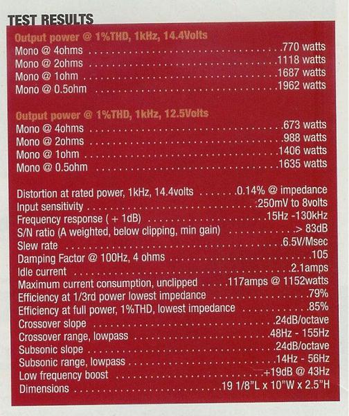

Username: N2audio
Lawrence, Ks
Post Number: 1566
Registered: Mar-04
The Lanzar's less expensive than many comparable amps because like many companies that are sold mainly online they have to provide a lot for the cost because the market is so saturated. Plus, since their overhead is lower than a lot of other brands they don't have as big a mark up.
The Opti 2000D, 4000D and 6000D have been pretty popular in the SPL lanes the past couple years because they're powerful, reliable, and affordable.
But CT douchebag up there seems to know better than the people that actually use them so his opinion is probably as good as gold.

this does, after all, look a LOT like "crap"...

that's the benchtest i was talking about.
I don't think ctmike deserved to be called a douchebag, he knows the deal opti.. but yes like you said, optidrive line is very decent.
Also they're not in the GOOD group of the list because they have budget lines... such as: viberant, heritage and vibe. Somo of those models work great and put good numbers, but the rest are bad.
