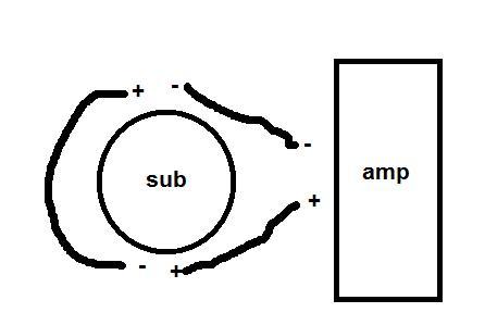

when you say your 1000/1 overheats, do you mean it overheats and shuts off or just gets really hot? those amps are known to get hot. the version 1 that is. they came out with the v2 that took care of the heat issues. also like reece said, it could be wired wrong. the sub is dual 1.5ohm. if they wired it parallel then it is going below ohm on that amp. it has to be wired in series. |

is it connected like this?
