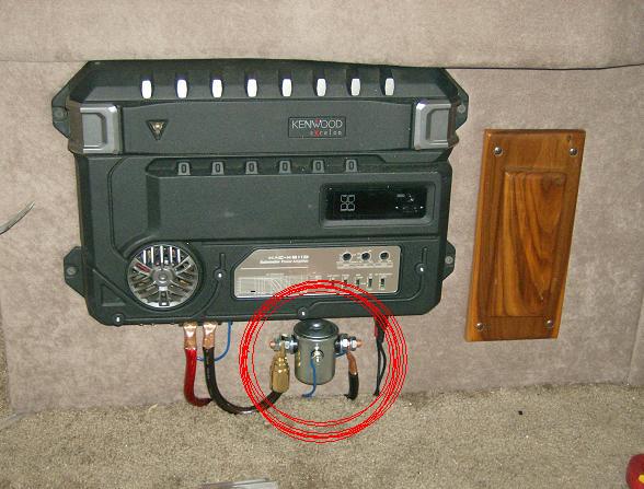

I concur, Removing ground is the best way to go. I have a solinoid on my sub amps ground that kills it with a switch or when the car is off. (dont ask)

"I concur, Removing ground is the best way to go. I have a solinoid on my sub amps ground that kills it with a switch or when the car is off. (dont ask)"
why do you have a solinoid on your amp Marc
