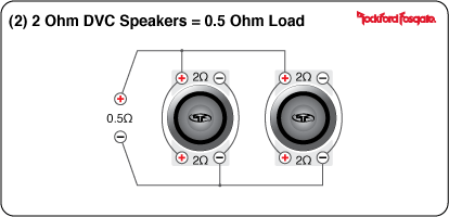

Post Number: 15459
"2ohmX2 is this still 4 ohm? "
Sounds like dvc 2ohm subs. Depending on how you wire the subs it could be.....
How did you wire yours?
If they are DVC 4ohm then it could only be wired at 4ohm or 1ohm.

Post Number: 1025
i'm going to take pauls advice here and say he's on the right track. i'm going to say your wired to .5 not 1 and as you crank it up the amp is strong enough to come alive then just die for protection of the amp. also the way you jump out and say thier wayyyyyyyyyy louder and you haven't even cranked them plus turning gains down makes a whooooollle lot of sense that your wired down to a low load. and 2 x 2 is not 4 it's typicaly 4x4 so i can bet this is your whole problem, try wiring back to a safe ohm load and see what happens, i bet your amp runs fine.

Post Number: 1338
You have a dual 2 ohm subs. Wire them like option #2 in the chart paul posted, into 2 ohms.

Post Number: 19732
dude there's your problem. you are going below ohms. 2ohm x 2 is dual 2ohms.

This is how you wire your subs...
If you thought you had 4 ohm dvc and you have them wired to 4 ohm.. then since they are 2 ohm dvc they are probably wired this way already... due to the subs 2 ohm voice coiles you are only gonna be running half the power that you need for those subs.. Did you buy them new... if so can you exchange them for 4 ohm voice coils? That would be ideal..
