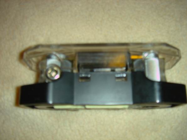

here is the fuse block i was telling you about. its yours. i know i have some distro block somewhere. i will find it over the weekend. i also have some 0 gauge terminals. they are all yours for free. lol.
pic of the fuse block. its already got a 100a anl fuse in it. its for a 4 gauge cable.

won't I need a 0ga fuse block though? lol
I'm more concerned right now about the distro block, since I will prob be ordering that KLM 0ga kit after I sell my zapco.
your distro has the 0ga in and dual 4ga out, right?
thanks again man!

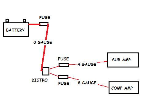

Post Number: 19703
yeah it has 1 0 gauge in to 2 out.
this is how i was telling you to do it.

Post Number: 2635
would it be easier to just get a fused distro(which is what I thought you had)? I can always pick up some fuse blocks for the 4ga anyway. I can put 4ga in the comp amp right, or will I have to cut it down to size?
when you say "1 0 gauge in to 2 out" do you mean 2ga or 4ga out?
thanks for the pic, it really cleared it up.

a fused mini anl (1 0g in 2 4g out) distro block like the 1 sold by stinger would look simpler\neater .....

that's what I was thinking Rovin, according to the picture the distro isn't fused, but I may be misunderstanding from him that it is.

well the distro block i have isn't a fuse distro block so that is why i put it like that. but like rovin says, getting a fuse distroblock would be better.

its good to have a fuse at the battery and if you are using a distro block then its good to have separate fuses for your amps.
now in the picture, i told thieves to do it like that cause i am giving him a distro block. the distro block don't have a fuse. now he can just get a fused distro block which would be alot more convinient. i think that is what he is going to do.

using a fuse isn't determine by how much power he or she is using. the fuse is there to protect your audio equipment in case of a short.

Http://www.rdaudio.net...
Post Number: 19728
ok lets say you are running a cable from the battery in the front to the back amp. you just need to fuse it by the battery and you are good to go. but if you are splitting that cable to separate amps, then its good to fuse it again from that point. regardless of how much power you are using. its always better safe than sorry.
for example, lets say god forbid somehow you accidently touched the + and - on one of your amps, you will cause a short and even though its fused at the battery, still a good chance you will fry your amp. now if you have a separate fuses for each amps at the distroblock, then your other amp is safe at least.

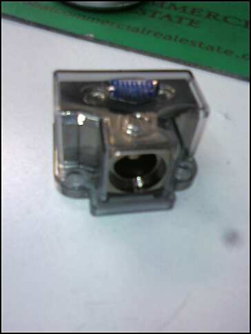

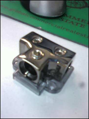

Post Number: 19783
thieves, here's the pic of the distro block i have. you can use this for ground.
