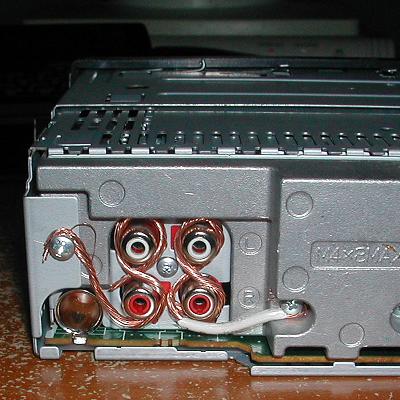

You need to ground your RCA's.

The humming noise is probley a bad ground ^ i would not ground your RCA's i've never seen that be4 and it don't look good at all..

well i tryed grounding my rca cables same deal,and as far as changing my RCA's i alredy tried that lol and nothing.

well bro pioneer hu's suffer from poor ground, i did that to my HU and suddenly all engine noises dissapeared.
IMO it is worth trying.
